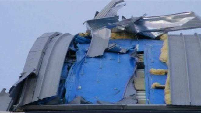

A long time since I did my civil engineering but I have a theory about the cladding's departure. The roof profile resembles a wing cross-section and with the wind in the SSW the airflow over the roof could make the roof act as a "wing" and thus generate a lift force that the attachments aren't designed to withstand. I believe we have had very strong Easterlies and Northerlies in the last few years and that doesn't seem to have had the same effect so it's the SSWesterlies that do it. Just saying.

The roof curve of the building doesn't face the SW - it is the flat end of the building that faces the SSW.
I suspect it is the 3-4m overhang which extends around 95% of the end of the hangar that is the problem - it is the roofing panels above the overhang that seem to become weakened and detached first (2014 storm damage was in this area).

I agree with you 'BobL', but the principles outlined by 'ozplane' still hold good for the gable over-sail (flat end) you described. The winds hitting below this overhang section are initially disturbed by the baffle effect of the exposed first Roof Lattice Truss & then almost immediately slowed by the solid gable wall. (see photo in Post 6 of this Topic).
Meanwhile, the winds passing above this overhang maintain a greater velocity by comparison & create a low-pressure zone, thus potential uplift! Add into the equation gusting & the vortex effect occurring both above & below the overhang to produce flexing in this section of the roof & you have a situation where all Fixings & Fasteners can become loosened after repeated cycles.
In these times of increasing high-wind events it's a problem that evidently isn't going to go away. A good start would be double the number of roof-sheet fixings & explore a new gable-edge profile to mitigate against uplift forces. Time to bring in "DIY SOS" ? :wink:

Stagger2 wrote:I agree with you 'BobL', but the principles outlined by 'ozplane' still hold good for the gable over-sail (flat end) you described.
Having read your theory and looked back at ozplane's post again I think I see what he was saying - it is that 3-4m overhang acting as a wing and not the cross profile of the building (as I thought he meant?).
I imagine the lifting forces exerted onto that overhang as the gales blew across the airfield would be quite high...
