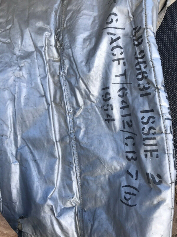

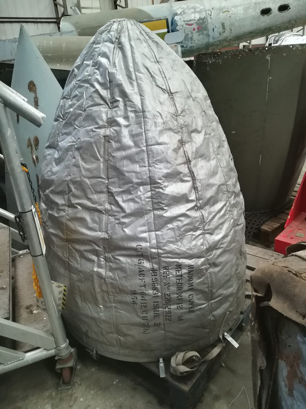

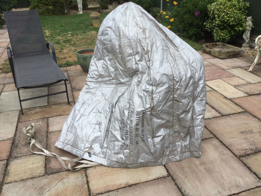

Acquisitions! Well, an acquisition... A few weeks ago I was made aware of a Meteor NF.12/14 radome cover on Thiefbay. I sent a cheeky message asking if the seller would feel like donating it to a worthy cause... and a few weeks later it's at Elvington and for the best price too! I haven't seen it myself yet, but here's a couple of pics from the listing...
And one Gary, our Heritage manager, took while putting out a (now I believe resolved) plea for a strap for it
It is a nice thing, and looking like new apart from one small easily repaired rip will serve 788 well for many years I hope.

Our new radome cover, now on the radome, donated by a lady in Lincolnshire. Naylan Moore had seen it on thiefbay, and made me aware of it. On the basis of "if you don't ask you don't get", I fired off a cheeky message, the upshot of which was she kindly donated the cover to the project, and also passed over a load of paperwork specific to our Fairey Gannet, XL502, to the museum! So thanks to all involved in letting me get my grubby little paws on this rare thing.

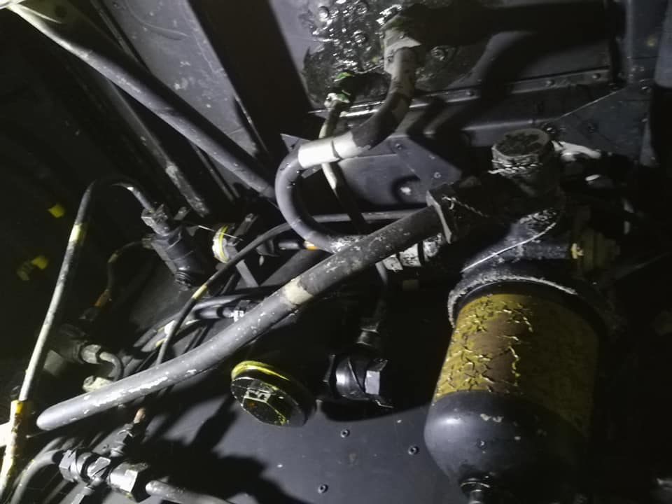

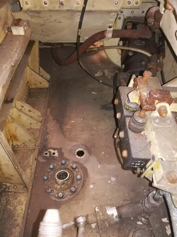

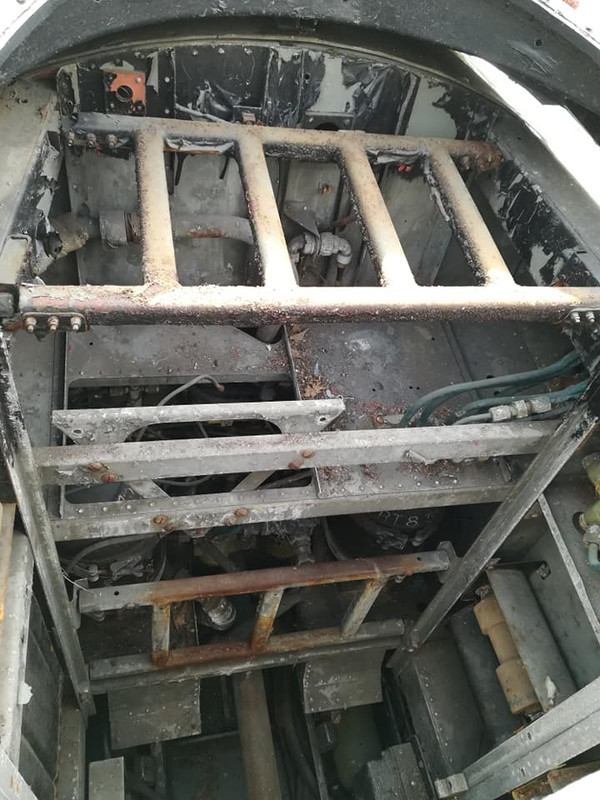

removing it is a different matter. First the back seat had to come back out, as 2 of the hyd pipes and approximately a billion 2ba bolts in the little bay behind the seat have to be undone. Once under there, the view upwards and forwards is certainly...different...
But inside that little bay everything is absolutely pristine, like new.
In that shot you can see the plumbing going up into the bottom of the tank bay, as well at (left) the hand pump filter and (right) the engine pump filter. Before the seat goes back in these will be pulled and cleaned out. The good news is everything is present and correct. Just out of shot to the right, the reservoir air bottle sits, and down below the accumulator is still fitted. Hopefully this is ok; if not we do have a spare. All the PRV's are in place too, so that's been a nice bit of finding! On the deficit side, I lost my last good 2ba socket in the bowels of the beast while removing this lot, so to eBay I go. Again...

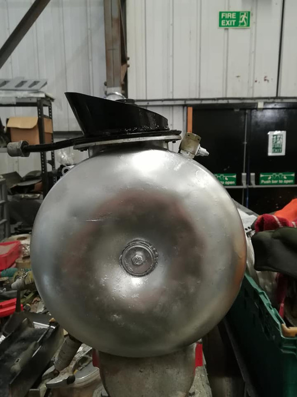

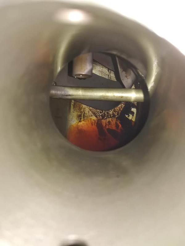

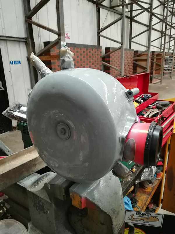

After extracting myself from the cockpit floor I moved up top. All the rest of the hyd unions undid happily, then it was the simple but slow task of undoing the 2 upper mounting bolts. This was a very slow task due to a distinct lack of tool access, but it did the right thing and gave up eventually. Once the tank was out, a cautious look in the bay revealed...

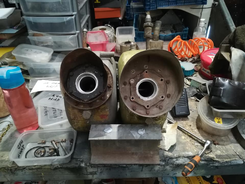

...nothing worse than muck and peely paint! That's a relief. The tank then went onto the bench along with its replacement. 788's original is on the left

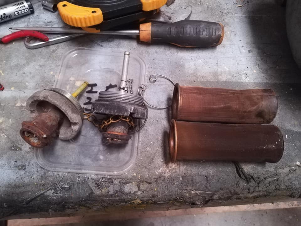

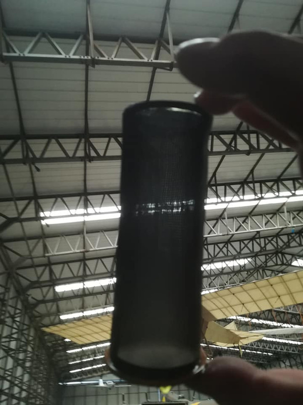

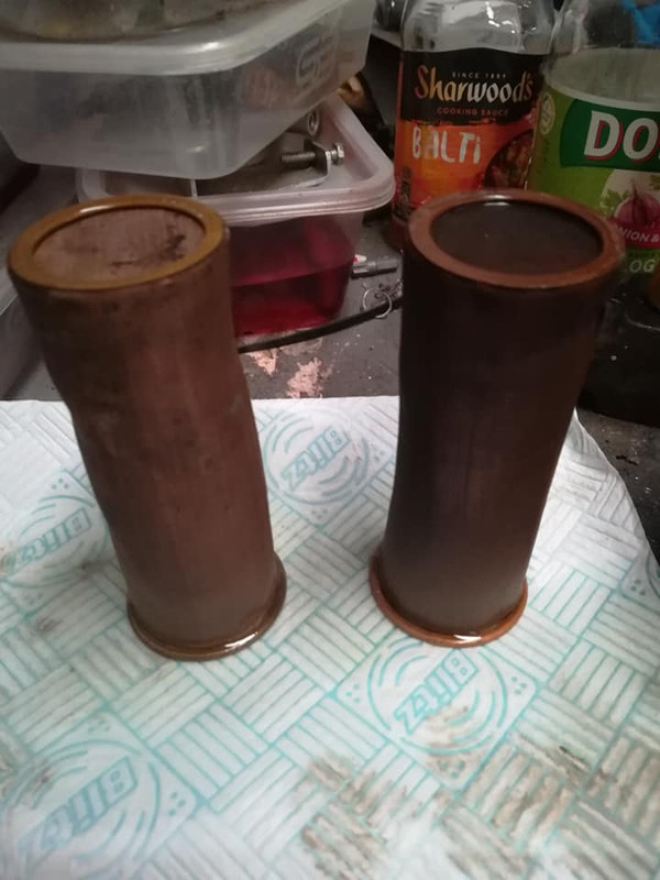

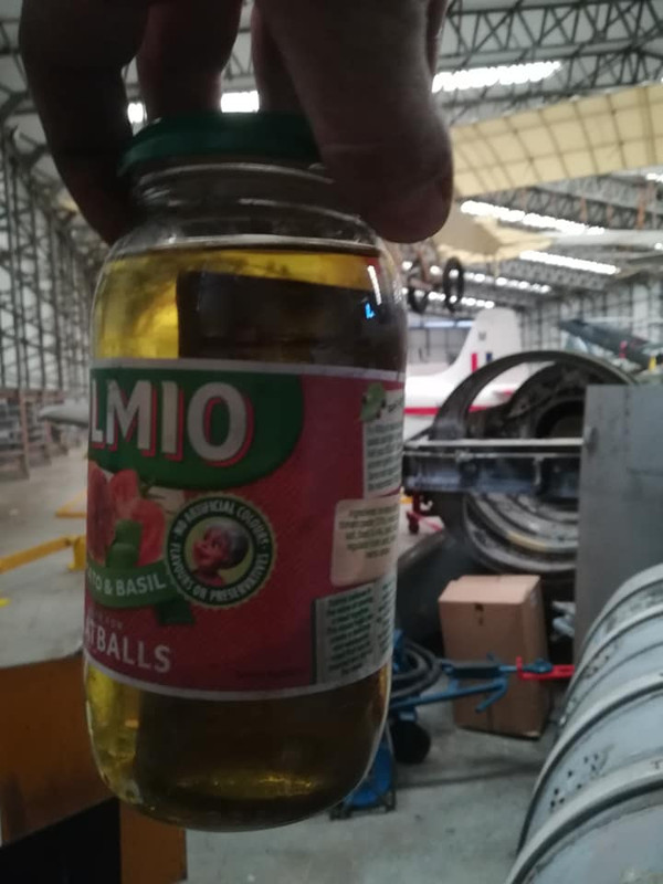

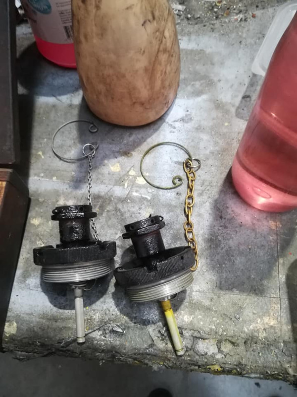

Once there the filler cap/dipsticks and screens were removed from both tanks. 788's screen is a bit battered but the new one is pristine

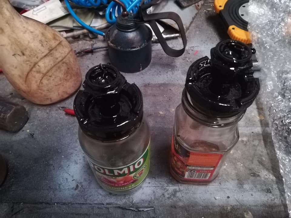

I filled a Dolmio (*other pasta sauces are available) jar with white spirit and gave both screens a good bath in it, to clear out the ancient gunked on hyd oil. That's nasty...
But after they both looked better...
And you can actually see daylight through the meshes, which you couldn't before!
the 2 lids, and there really isn't anything to choose between them as to which is the better candidate, were rubbed back and painted too

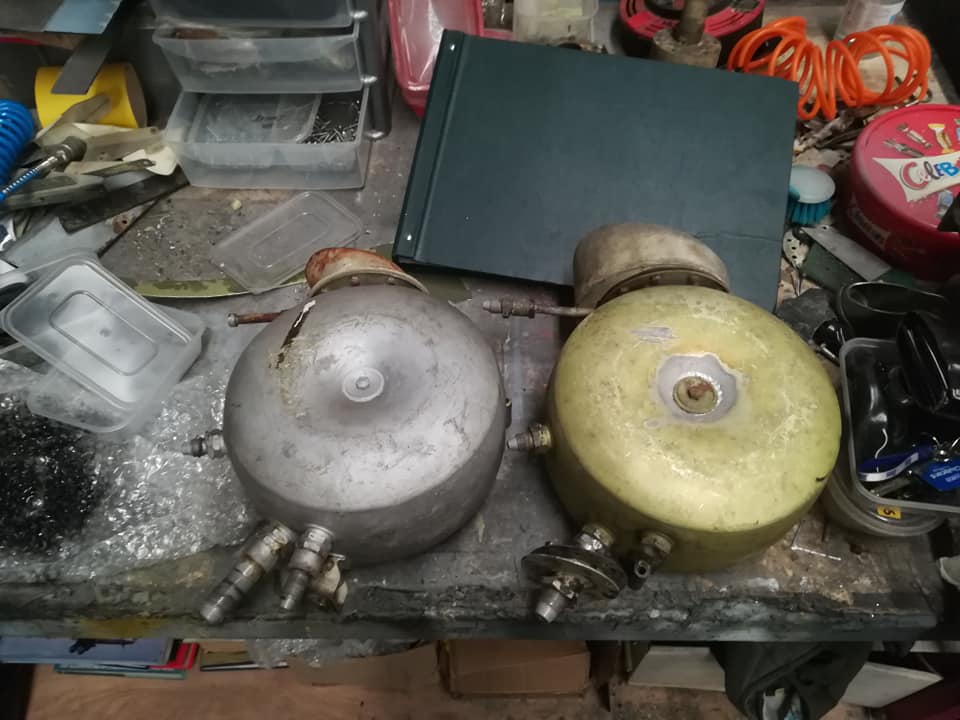

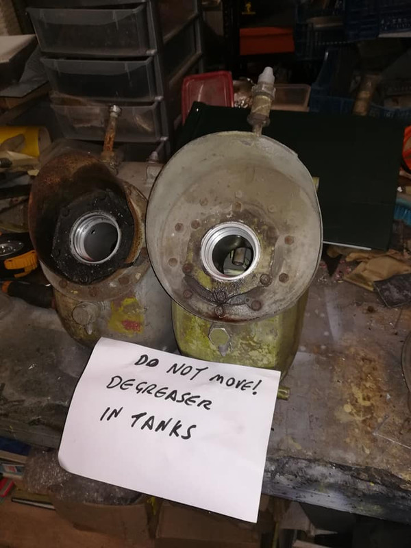

Back to the tanks, and they both had a generous splash of degreaser chucked in to help shift the gunky sediment in the bottom of each tank. We don't want that in there!
I left them on the bench with a subtle and polite note, aimed at curious fingers!

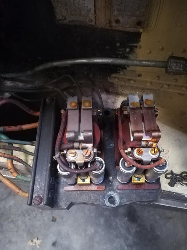

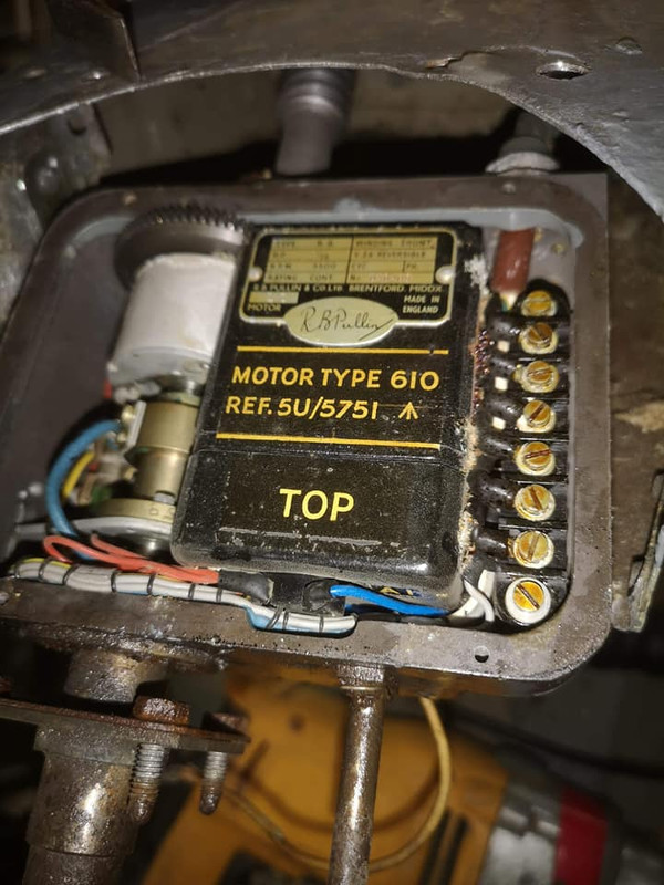

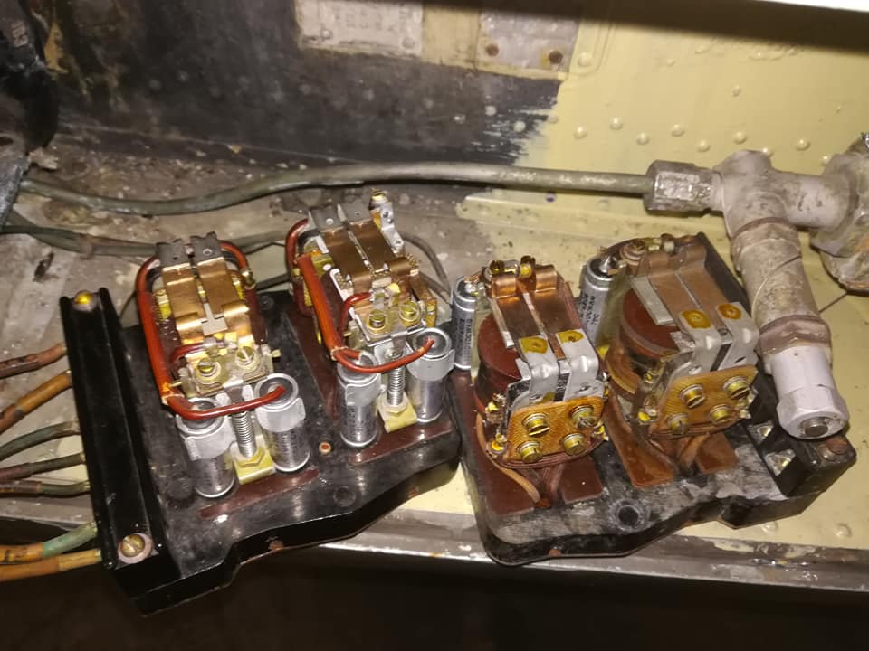

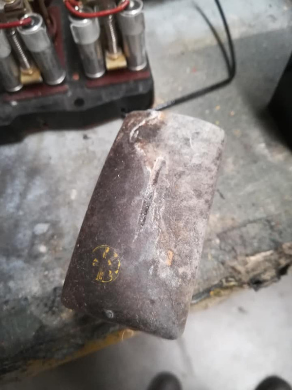

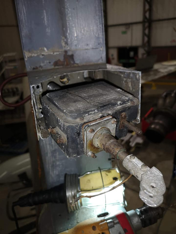

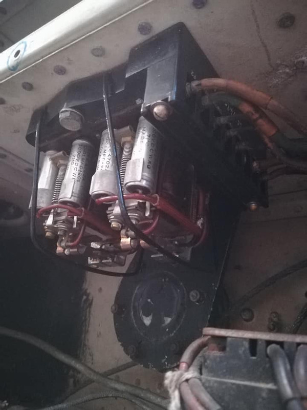

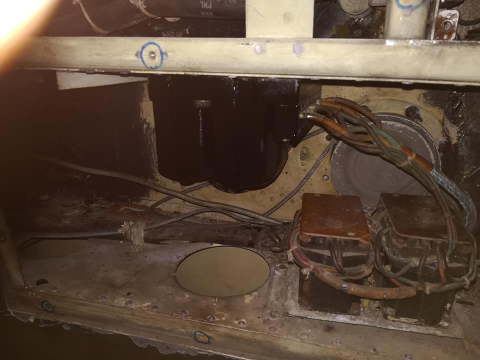

Then, back to 788. You may remember back in the mists of time we had discovered the contactor pair in the starboard nose bay was missing a cover and that as a result one of the contactors had got a bit, well, manky? You may also recall that slightly less far back in the mists of time Bruce of GB Airspares (or St Bruce of Norwich as we like to call him!) came to our rescue with a NOS set? Well, I decided to get that swapped yesterday too. The old unit, it's easy to see which contactor has been bereft of its cover for many years...
The missing, cracked and manky cover, found in the depths of the nose section. Nasty...
Swapping the wiring from the old to the shiny new...
Fitted to an aircraft for the first time in its 60+ year life...
Covers on, job done!

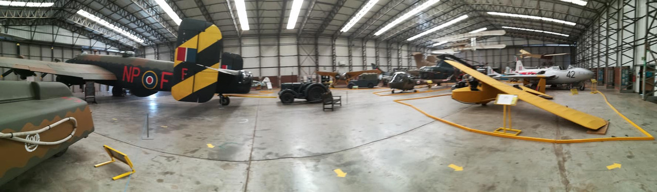

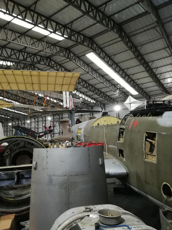

Also, as a little bonus... a couple of views of the reorganised hangar.
I have to say, it's very different... and I like it!

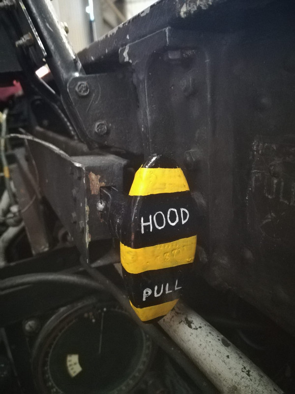

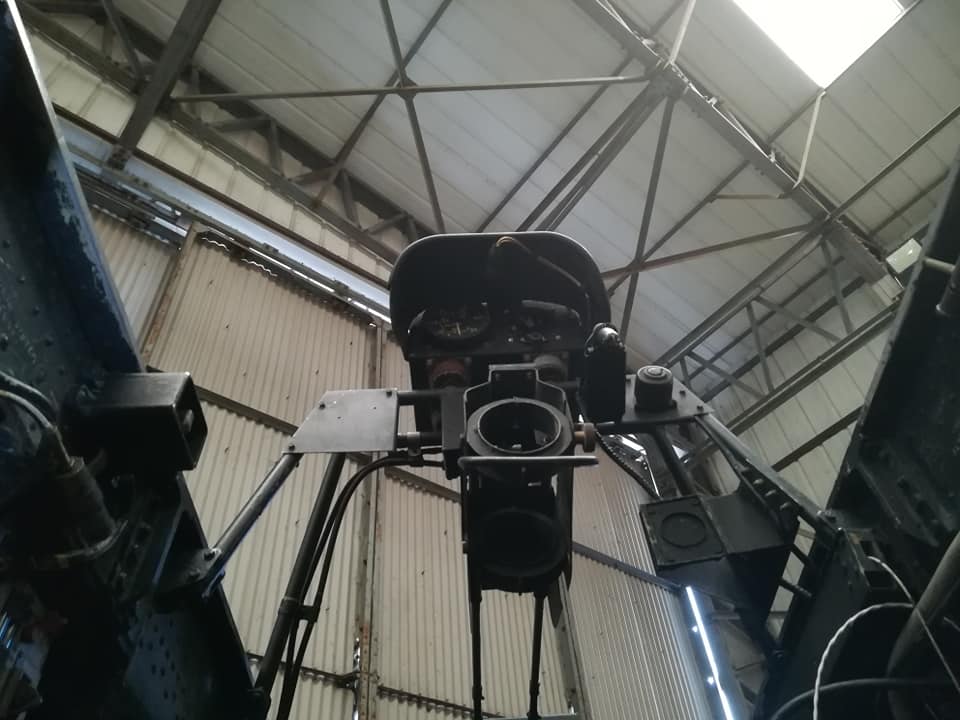

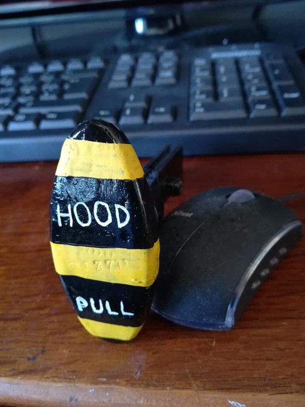

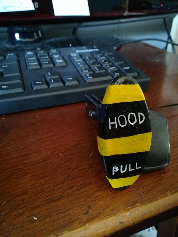

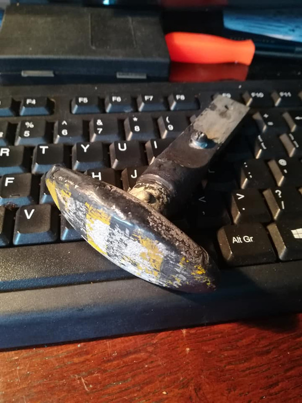

Got one little bit of homework done yesterday. On Sunday I got sick of seeing the nav's canopy jettison pull dangling from its cable in the rear cockpit looking sad, so I removed it and brought it home.
Yesterday in between jobs I got it sanded back, etch primed, and repainted and it now looks much happier!
I think it looks a much happier thing now. Yet another tiny but time consuming job ticked off the list!
Posts: 95
Cool - what's it used for? (:D)
Posts: 403
I thought that would be obvious; it's there to deploy the hood on your Official Merchandise Oasis Tribute Parka when is starts raining, so you don't get your hair wet!

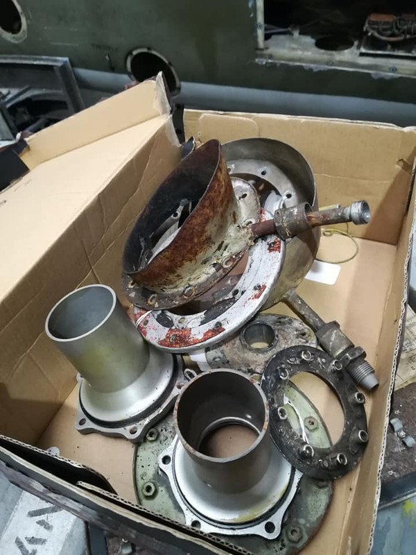

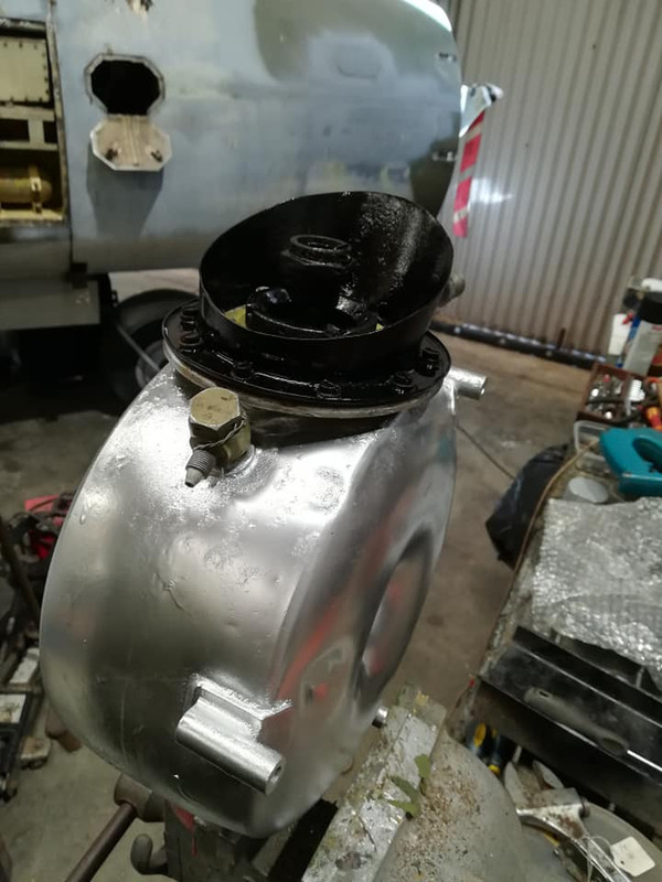

Then to the bench, to start stripping and labelling the parts of both hyd tanks
The filler caps turned out nice too...
I was hoping to get the component set I would be reusing stripped, cleaned and in paint by the end of play. Amazingly, while neither tank will have seen a spanner since the 1960's at the most recent, only one bolt fialed and sheared. Typically it was on the filler neck of the tank I intend to reuse. So that would want a drill. With Simon happily installed hurling abuse at the tailfin...

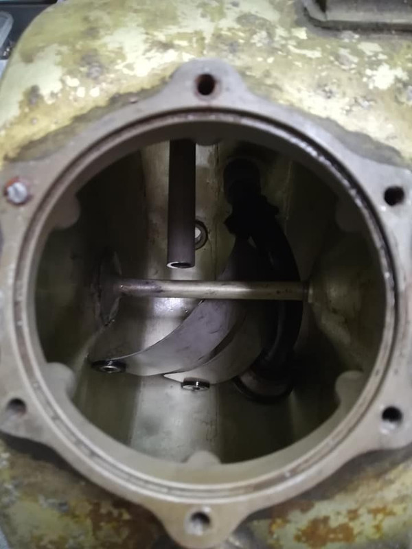

I carried on making a box full of tank parts

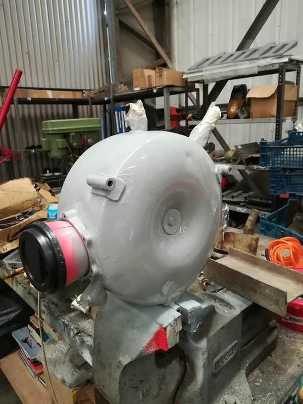

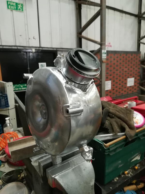

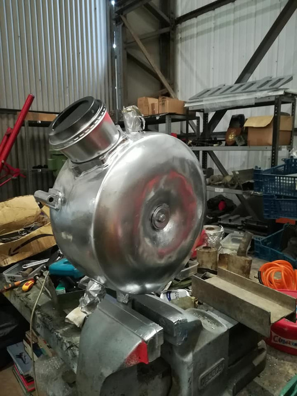

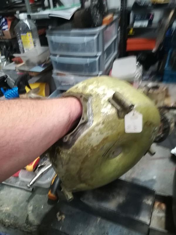

I cleaned the degreaser and sediment out of the tank we are using, then had to stick my arm in it to refit an internal pipe and a baffle. that was fun, when it was unwilling to give me my hand back...
It gave though, and the pipe and baffle were back in harmony in a clean, shiny tank. You can see in this pic the sheared bolt at the 10 o'clock position; it soon succumbed to the drill and the tap set

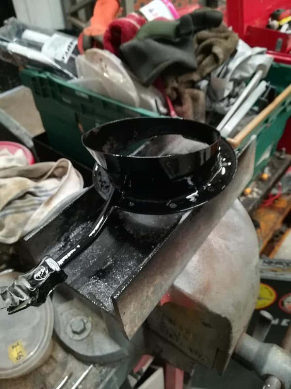

The tank was then rubbed back and primed. The coffee cup to mask the aperture is of course factory...

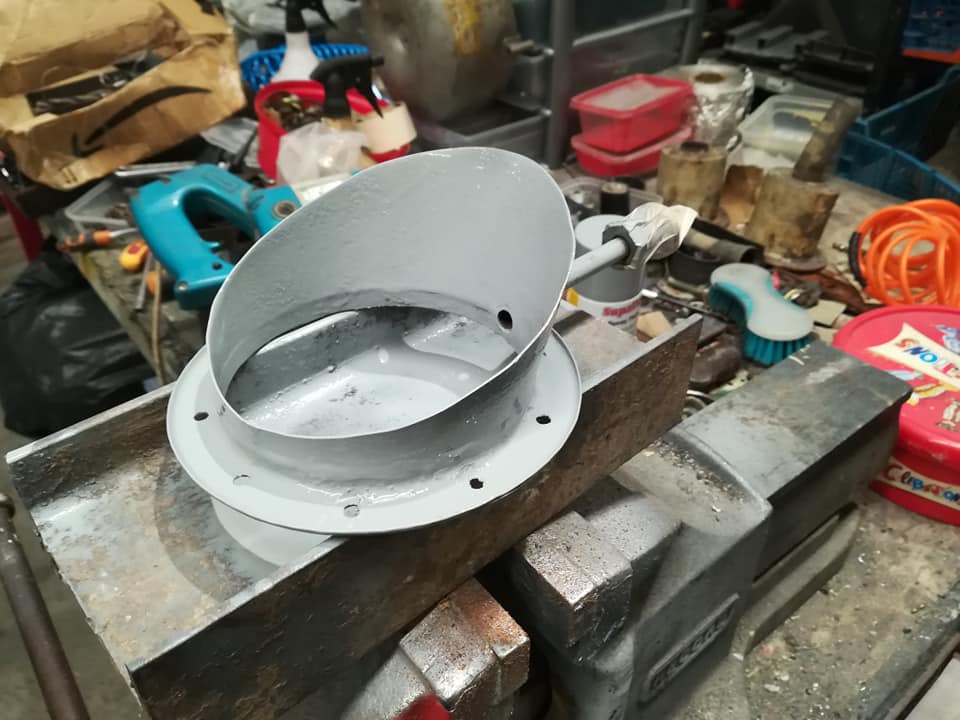

788's original spill tray was also knocked back into shape, rust treated (yes it's steel...), then primed
And shortly after painted

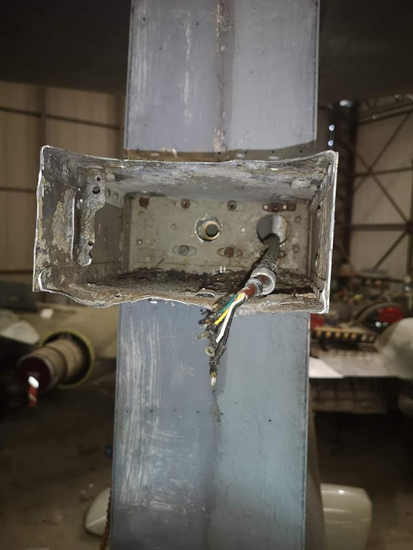

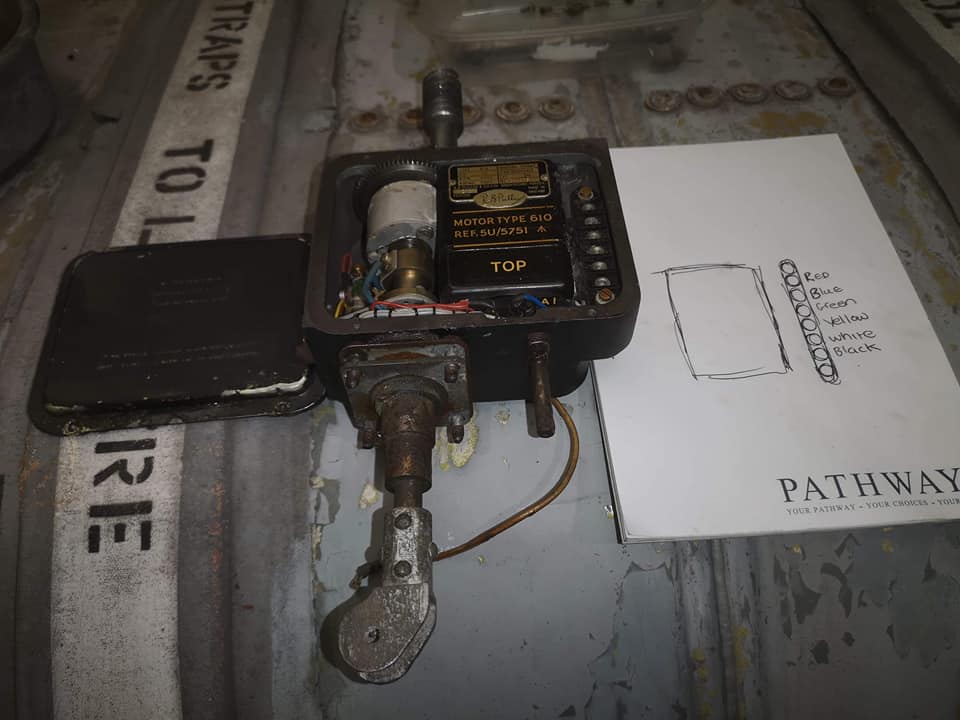

Back in the hangar... Simon was making progress in the battle with the autostab. You can see why it all has to come out, and that there's some metalwork in serious need of retiring and replacement items fabricating. After clearing the old bits, carefully aas he'd need them as templates, Simon started making progress...
Removing the lid of the unit to undo the wires revealed it to be in excellent condition internally...
After a fight from the cable shielding, it was out!
The unit, with the wiring all diligently labelled
Simon spent the rest of the afternoon making up the replacement metalwork for that bay, using the rotted remains as templates. I spent the afternoon painting the hyd tank...
Then, as it was warm and the paint dried quickly, reassembling the tank
It's now on the shelf out of harm's way. That was it for what was an enjoyable and productive day. Next week, strip more parts, i.e the canopy motor and latch from the hyd tank bay, and see what sadness they bring our way...
