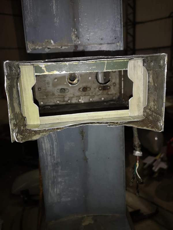

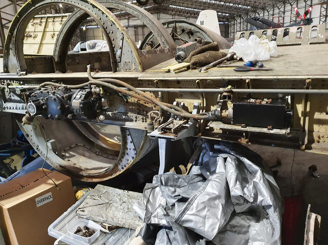

So the year started with the canopy stripped, and the frame beginning to recieve some tlc.

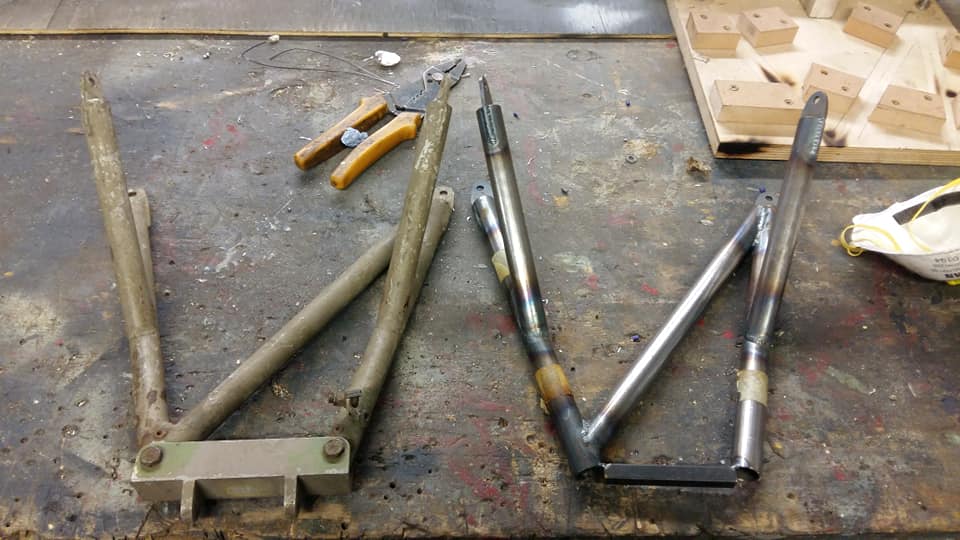

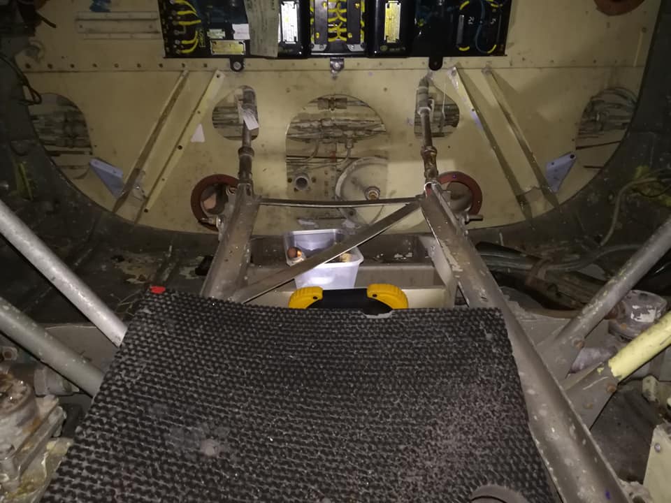

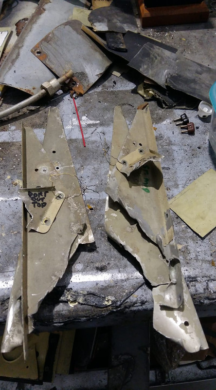

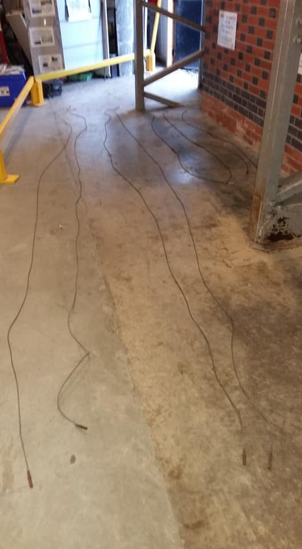

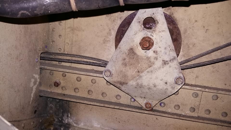

It also saw the beginning of putting right this mess, the rear fuselage rudder cable pulleys
The removal of these smashed brackets was a long, drawn-out affair due to the fact that access is rather on the poor side!
But I prevailed, and they would prove invaluable in making up templates for manufacturing new brackets for the jet. We also got a replacement for the missing IFF aerial under the nose made up

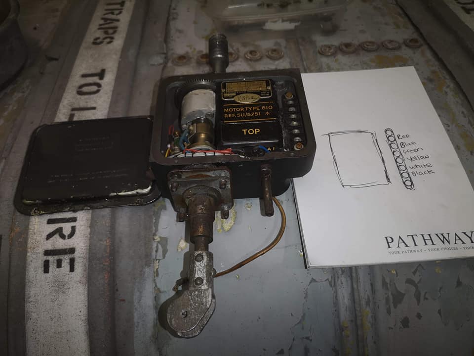

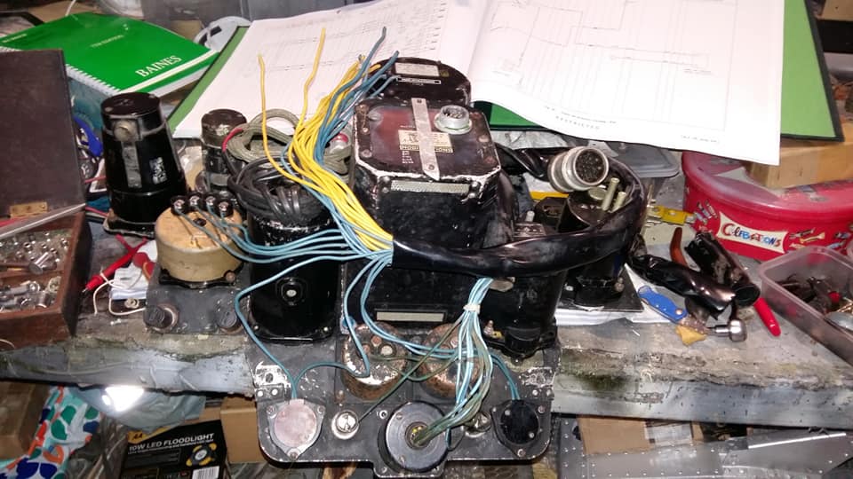

And, in among all this, I made a start on reinstating the front cockpit electrical systems, starting with the lighting.
March

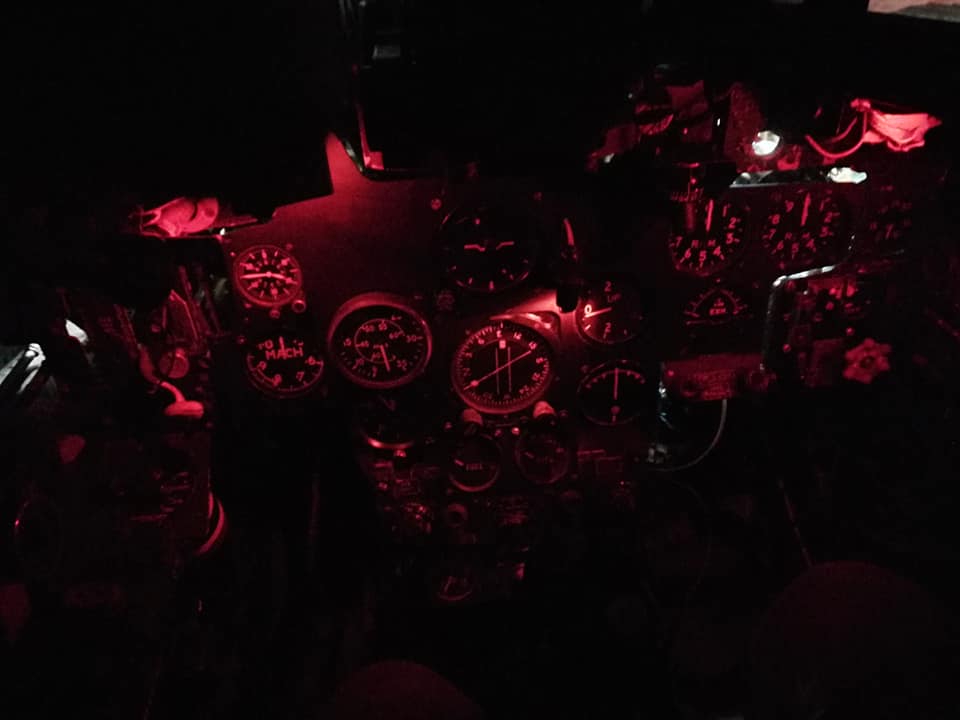

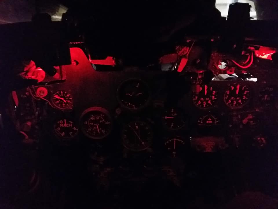

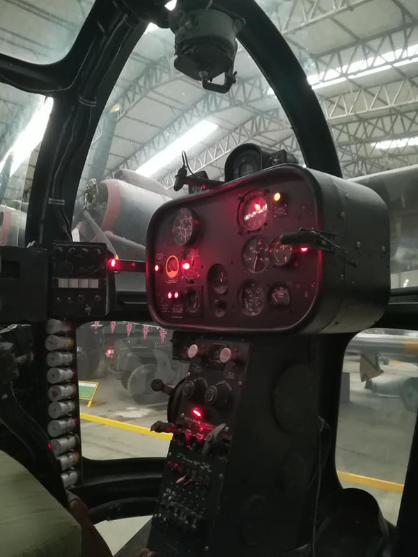

started brightly (literally) with a full set of lamps ready for refitting to 788's front office
and in fact we got some fitted and running directly from our test battery straight away!
As I had some back issues early in the month, I stuck to the lightweight job of trying to modify 2 spare instrument panel feed looms to become the next looms along the line. This would give us feeds to all the instruments, and all the lighting and their controls on the main panel, from their respective junction boxes.
A lot of chasing blue and yellow spaghetti with a meter ensued...

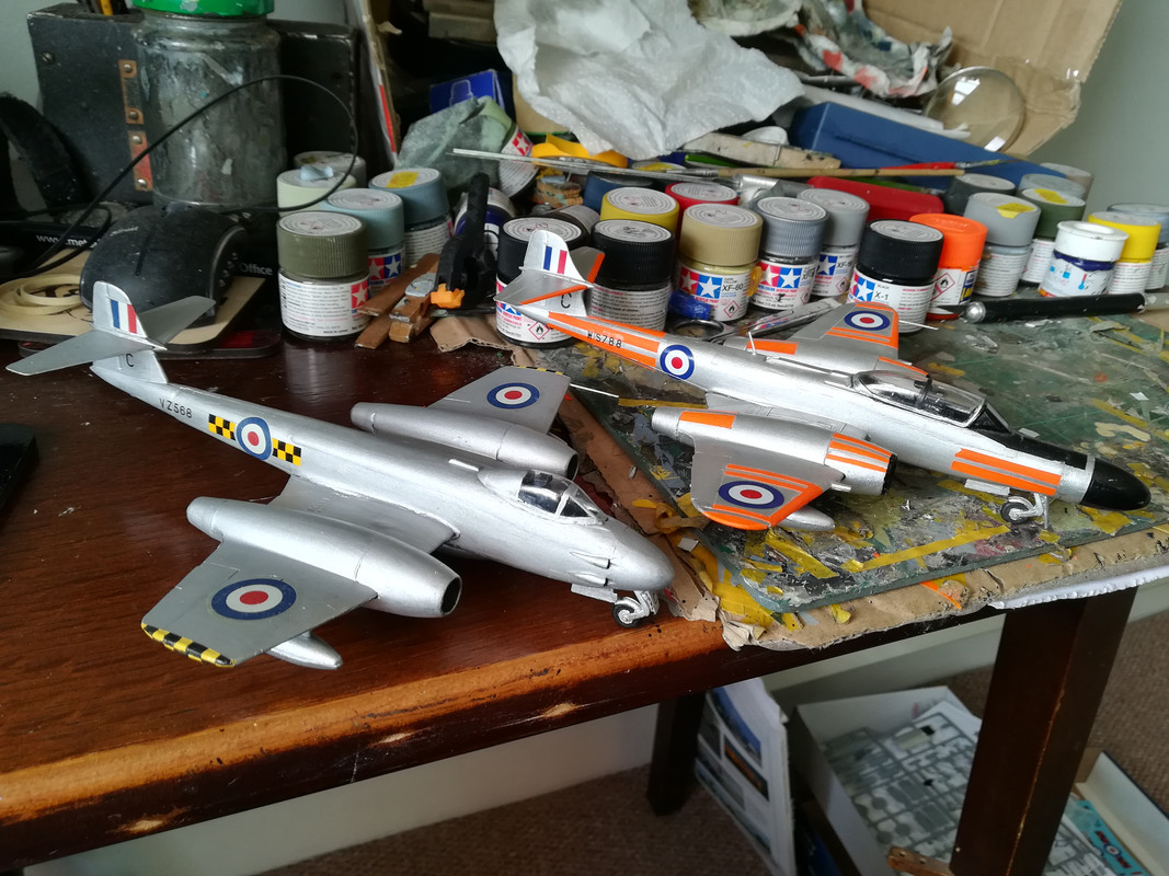

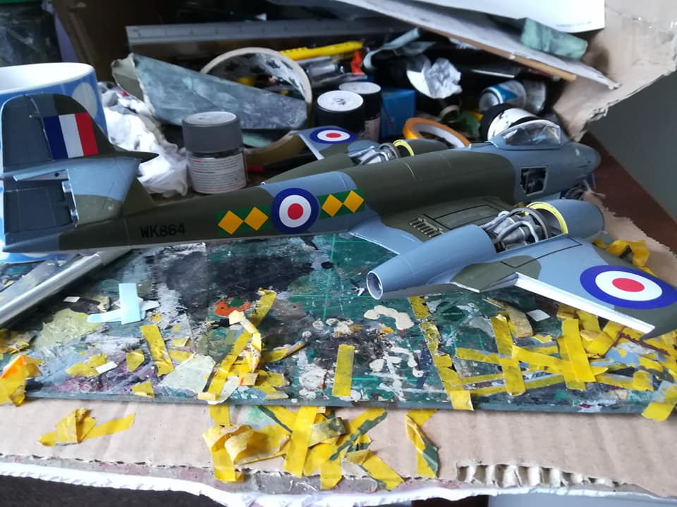

started as April finished, trying to keep occupied. Models helped massively, I finished the builds in 1/72 of 568 and 788
The Sword 1/48 NF didn't hang around on the bench for long either!

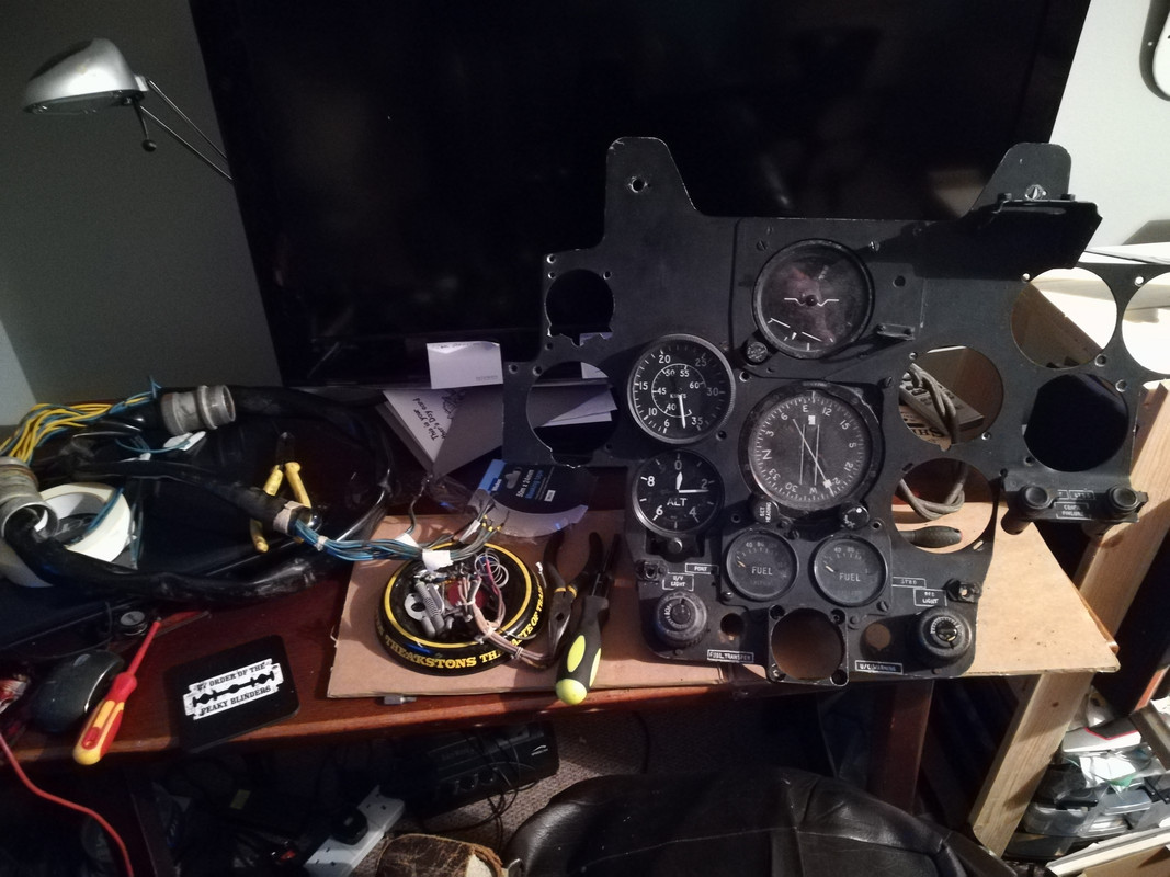

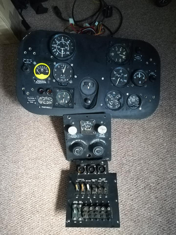

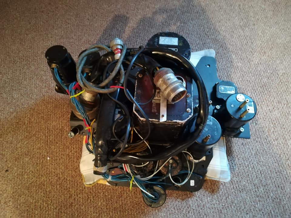

Also in June, the main panel out of 788 arrived with me for a refurb.
I know it doesn't look bad... but it could look much better. So I set to, stripping the instruments out and cleaning and restoring them as required. These all came up nicely, the horrible paint on the panel defied my attempts to remove it though, so off it went to our friends Joe and Lyndon Blackburne who had kindly offered to strip it back and repaint it for me. I carried on working my way through the instruments, including the pilot's oxygen regulator

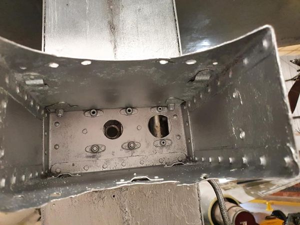

And Simon finally claimed victory in his battle to extract the rudder autostabiliser!
This meant he could get on with stabilising the corrosion in its bay on the fin and make replacements for the metalwork which had corroded away, which was the original point in removing the autostabiliser. He really has had a Battle Royale with this most stubborn little *insert expletive here*, but he won in the end.

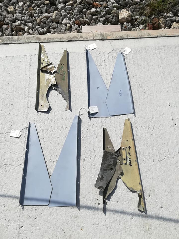

The next task I moved on to in August was making up the replacement rudder cable pulley brackets. I find fabricating new components quite an enjoyable process and challenge, and these new brackets with mangled twisted scraps as my only guide proved to be no exception
The metalwork theme continued in the month, with me adding the replacement bracketry in the rear fuselage...
...and Simon doing likewise for the rudder autostab bay

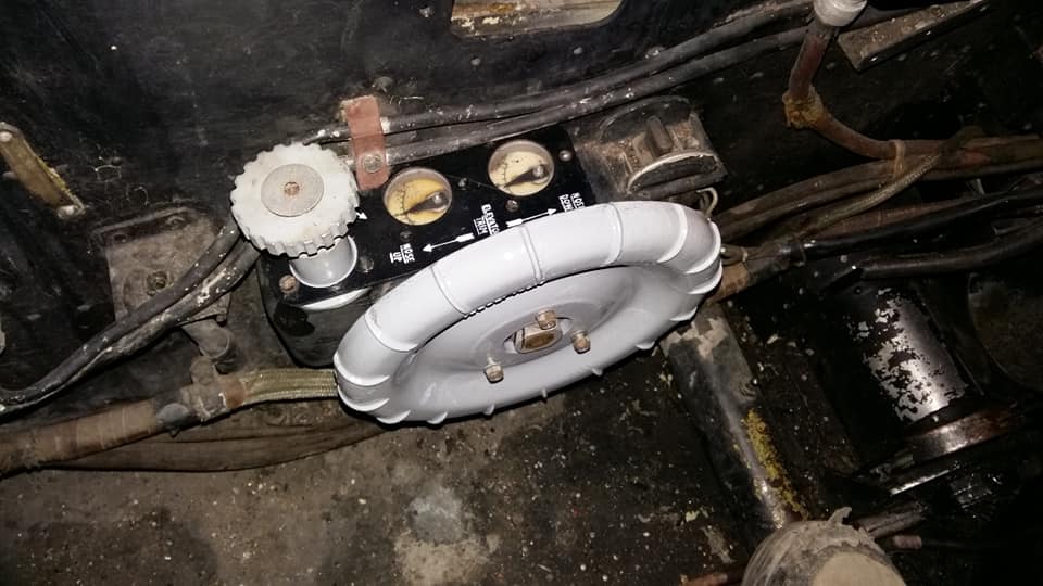

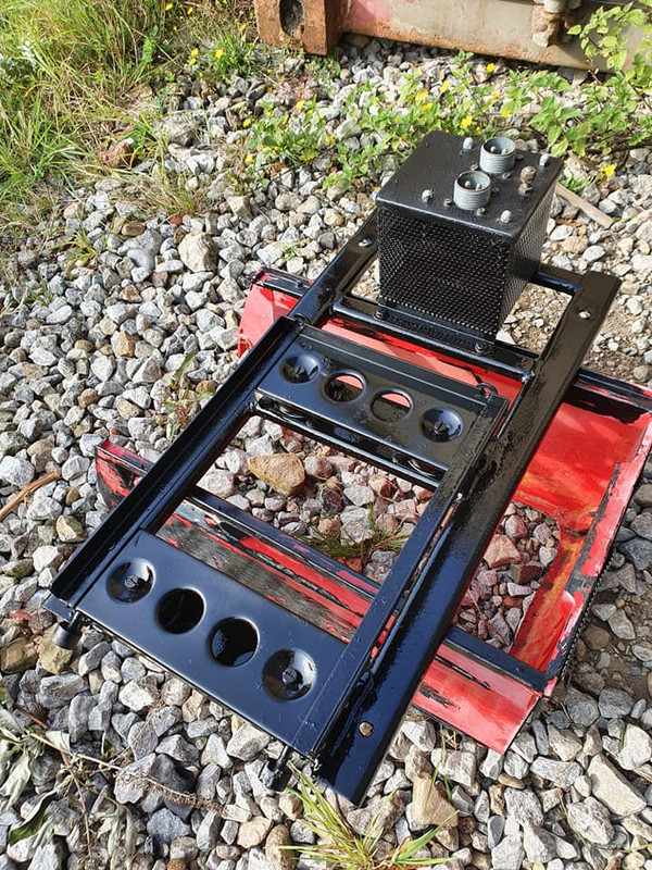

Little job done this evening, when we went to deepest darkest Wiltshire at the weekend to pick up our new side project off Nigel Coward, he also gave us back the case for our Rebecca controller which we lent him to replicate for his Canberra T.4 cockpit project. When I restored the case, I just sent him the case only without the guts as they are quite heavy and it was to be posted. Now the shell is back, it's time to refit the innards...
Soon done. The front looks no different...
...but from behind you can see the innards now fitted. In addition as you can see, the mounting bracket is now also refitted.
So, that's the controller ready to refit! Some time in 2021 I assume...

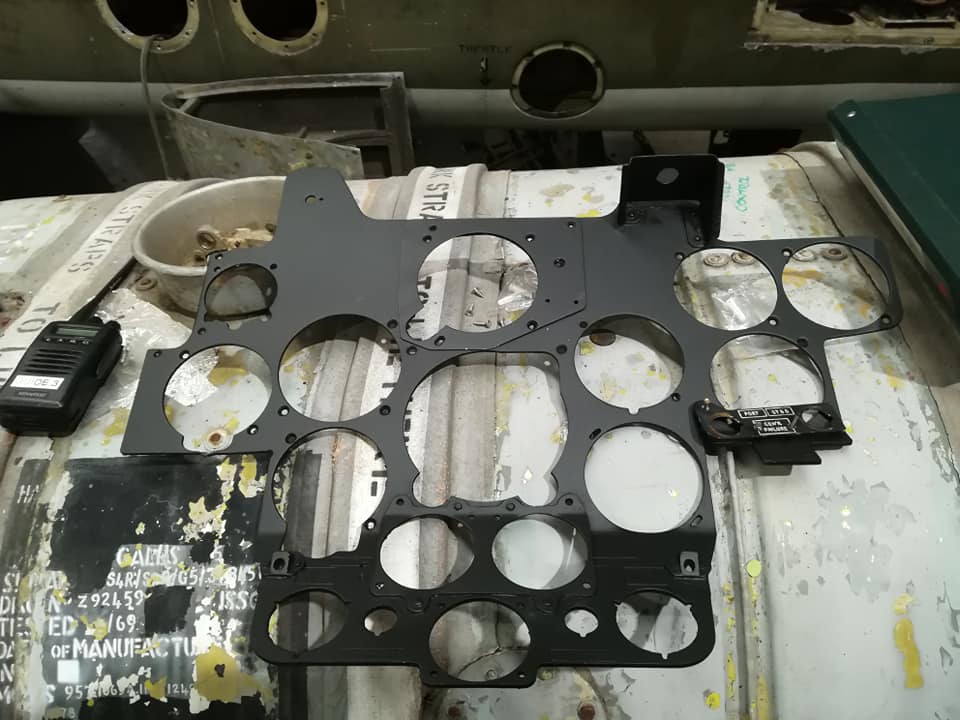

Happy 2021 everyone! And it's fair to say that the year hasn't made the best of starts. A not unexpected lockdown means we can't hit the ground running as we would have liked, but I have at least had one little project to get on with, the "travelling exhibit" NF.14 panel build. Just before Christmas this rather lovely bare panel blank, made using precise measurements taken from 788's panel, arrived in my sticky little paws.

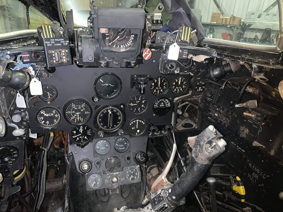

So I busied myself drilling out the marked holes, then when I was ready I fitted the plate the fuel gauges mount on and the surplus old ILS light bracket formerly fitted to 788
Earlier this week I found myself with the time to start test fitting the instruments in the panel
Remarkably little fettling was needed to make them fit. This fettling was done today, I then took advantage of a rare warm ray of sunshine to get the panel etch primed
then, a second warm ray of sunshine happened along so I got the matt black top coat applied
Before spending this afternoon mildly fettling and final fitting the instruments!
All that remains it to fit my other fuel gauge, 4 lights which thanks to the magic of ebay will be on their way shortly, then make and fit a mounting bracket for the E2 compass, then job's done! This along with the NF rear cockpit electrical control panel will form the basis of a travelling exhibit telling the story of our project, and raising the profile of the Meteor NF in particular and YAM in general

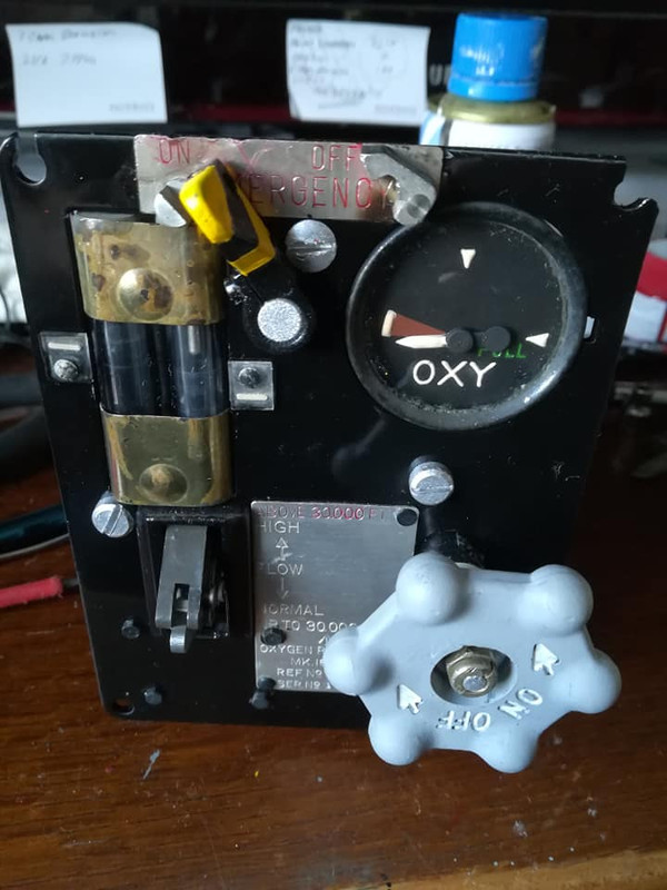

A bit more done on the NF display panel this weekend, our Heritage manager Gary part built a bracket for me for the E2 compass, then sent it to me to finish, drill and paint. It is seen here with the E2 being test fitted
After this it was dismantled again, etch primed and painted matt black, before being riveted to the panel and then being reunited with the compass.
Also I was able to get my hands on our spare fuel gauge once more, which has now taken its place in the panel
This gauge was last fitted to a panel 60 years ago. It's host airframe? Sister ship to ours, WS787. 787 survived to the end of NF ops at RAF Tengah, Singapore, and on retirement became Tengah gate guard. When the RAF vacated Tengah they took 787 with them, and she ended her days on the RAF Gan fire dump. 2 sisters with very different fates... anyway one of her fuel gauges lives on with us
So, just the lights to do, then that's the NF panel done. Looks pretty good with the NF stick top!
