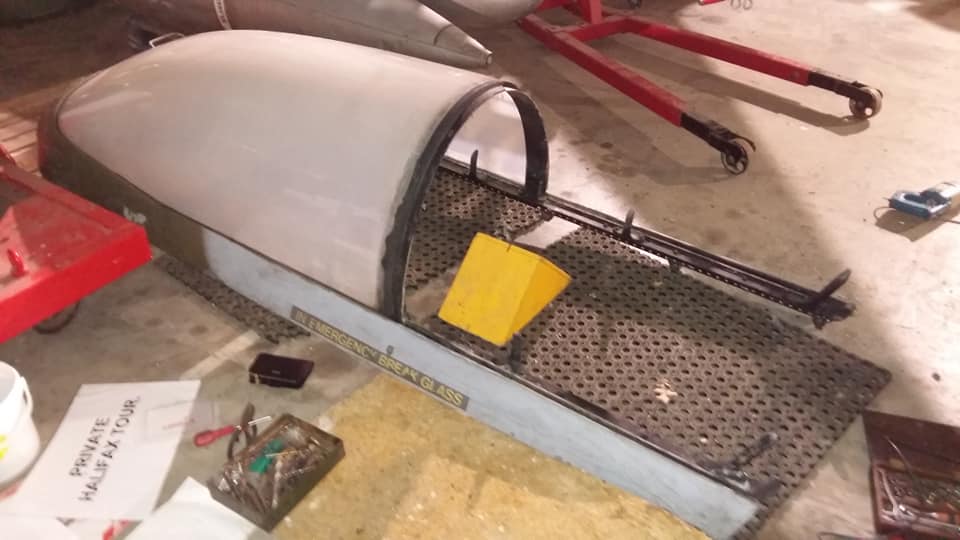

We had decided Simon would get on with the canopy strip down, Scott would forge ahead with the riveting with my assistance when needed, and I would get on with replacing all of the duff captive nuts in the 2 main nose side access panels. So before lunch was declared we set ourselves up for these jobs. We cleared a bit of space round the canopy as someone else had dumped their crap encircling it, and set it up so Simon could start battling the billion screws holding the perspexes in the frame

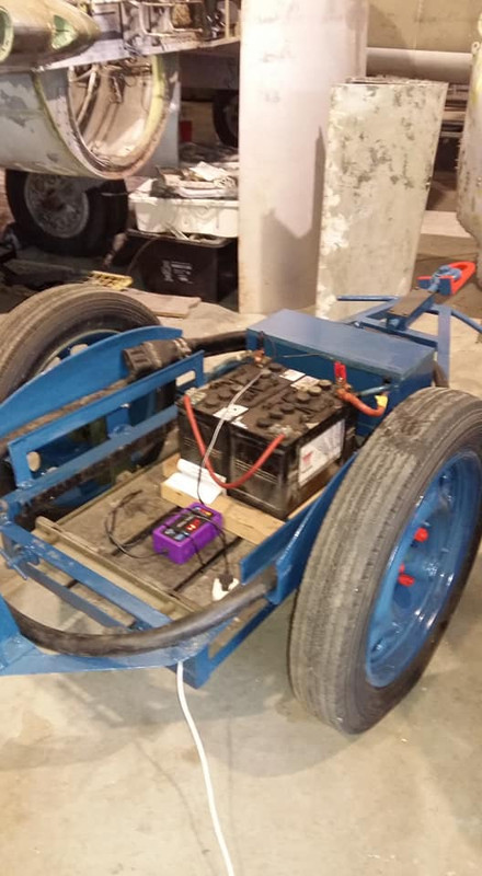

I also moved the trolley acc closer to the plug, as it's due a charge. While I was at it I fitted the fire extinguisher bracket, a job which has been waiting patiently for Eloise to get round to for a while now!

Simon began waging war on both his own drill bit stock and the canopy screws...

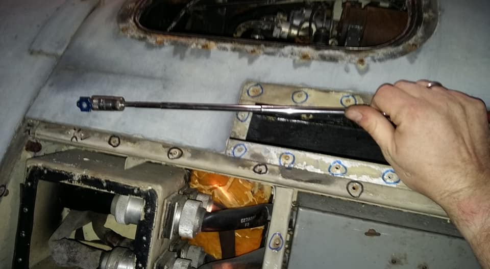

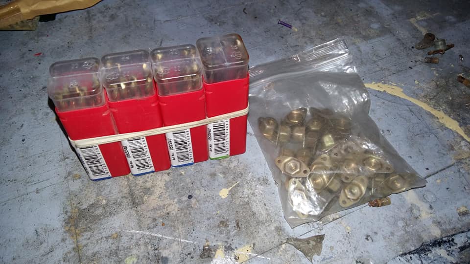

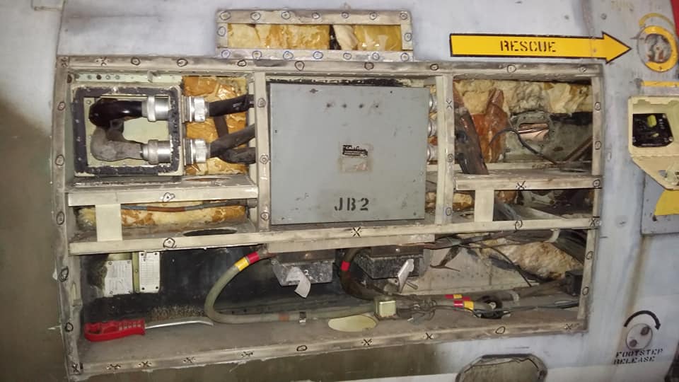

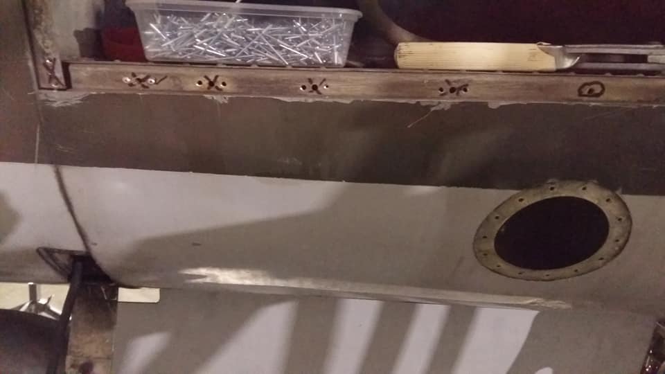

and I made a start on removing the duff captive nuts from the port electrical access panel. All the ones marked with an X need to come out
...and it's always the ones which are most awkward to replace. More on that soon. Some of the drilled out ones were able to be salvaged and re-used by putting them in the vice and persuading the stump of screw left behind to unscrew, but I did have to raid the cupboard for my own rapidly dwindling stock of 2ba captives too. When you start using quantities of them, they become surprisingly dear... I had one to replace , it's the furthest left in the below pic. The only access is from that hole bottom right...
I managed... but it left it's mark!
I then had an absolute genius moment. In the tools I had sorted that morning was a magnet on a stick... I wondered if...?
Excellent! So this meant I could do all the awkward, inaccessible ones both sides and retain my skin. Win!

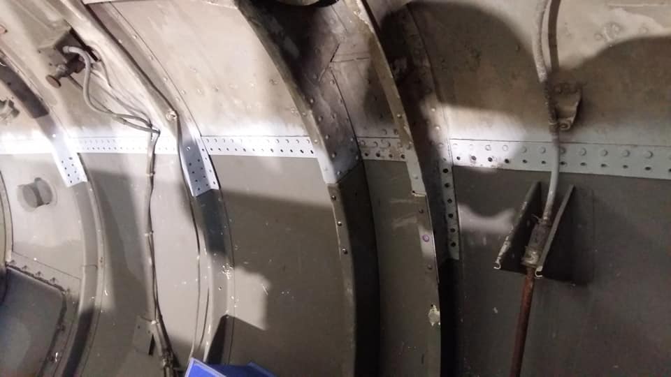

I was then called away by Scott to help him bang some rivets in. "Beware OF Noise" signs were deployed, and then we got on with it
Close of play, which on Winter opening hours comes around all too quickly, saw a number of holes filled by rivets
The front part of the canopy moving in its frame

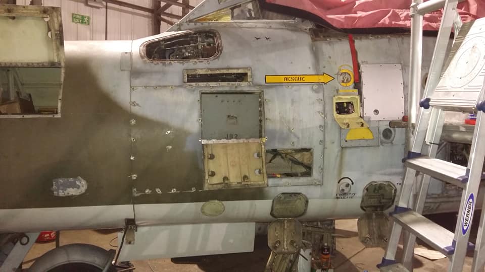

And both side access panels with a full set of captives, and screwed back on the jet for now. Until our pet electrician Kev Penfold can pay us a visit we don't now need to be in these bays again, so fitting the panels means 2 less things for us to trip over!

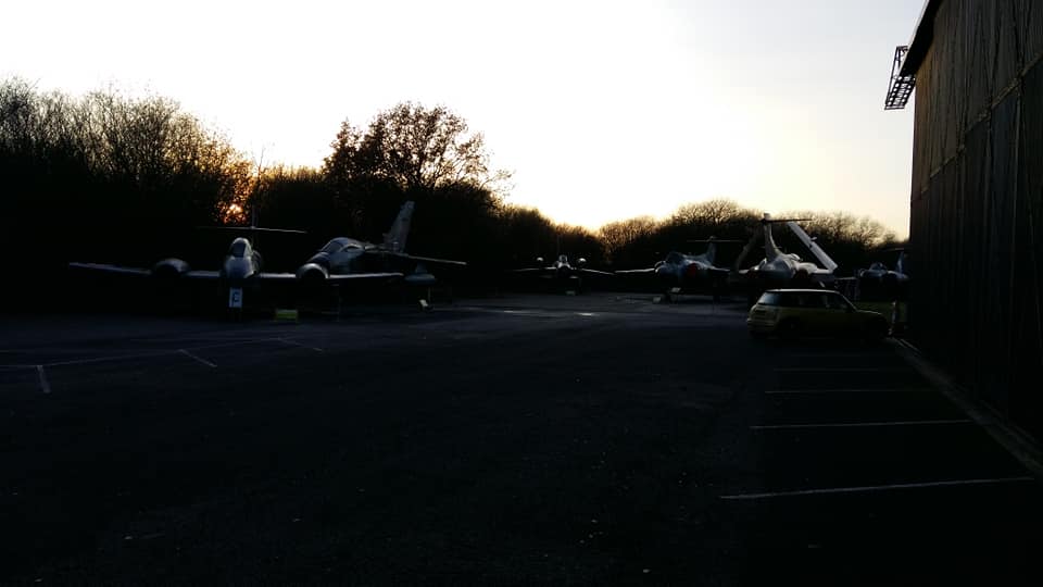

In the meantime I shall try to appease you with some pics of the jets in the autumnal sun

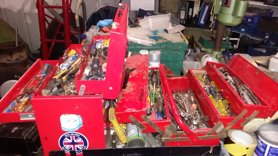

Blue_2 wrote: found behind the bench another toolbox which I had retrieved from the ex's, so I decanted the contents into our main toolboxes and chucked the box away, then sorted our toolboxes a bit better.
What???
Posts: 403
What???
It was truly knackered. Had to be for a Yorkshireman to skip it! :lmao:

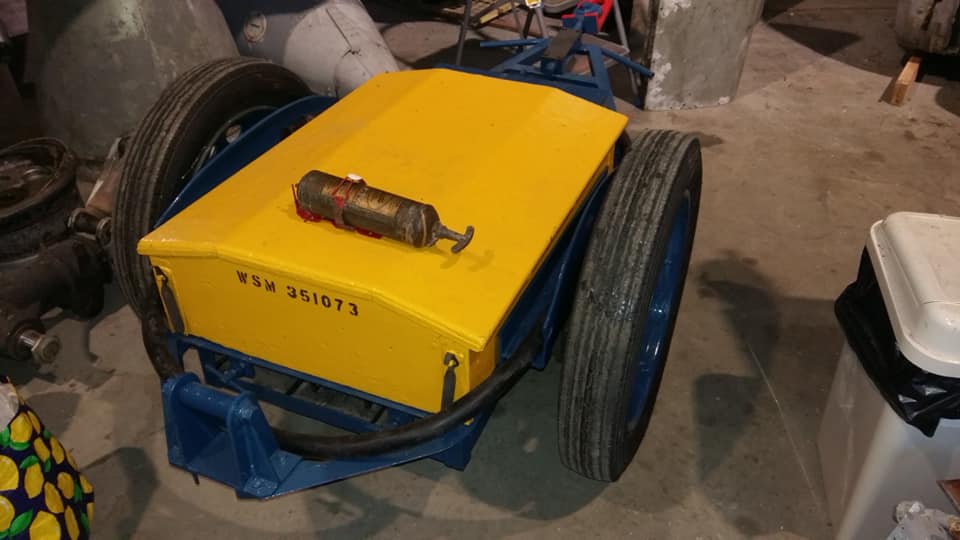

We then got our restored trolley acc on charge. It was due a top-up anyway, and Scott thought he might need it to do his jobs on 168 if he couldn't lay his hands on a suitably juicy battery...

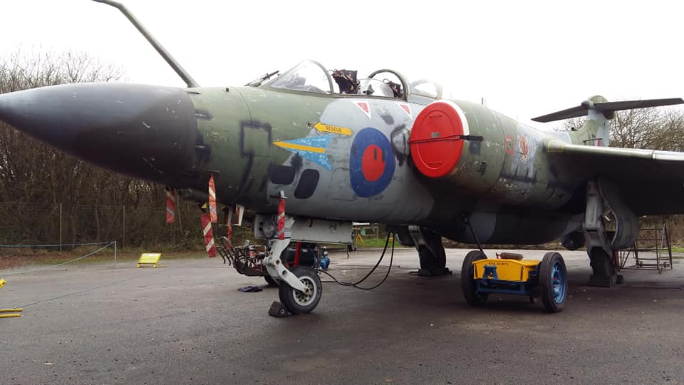

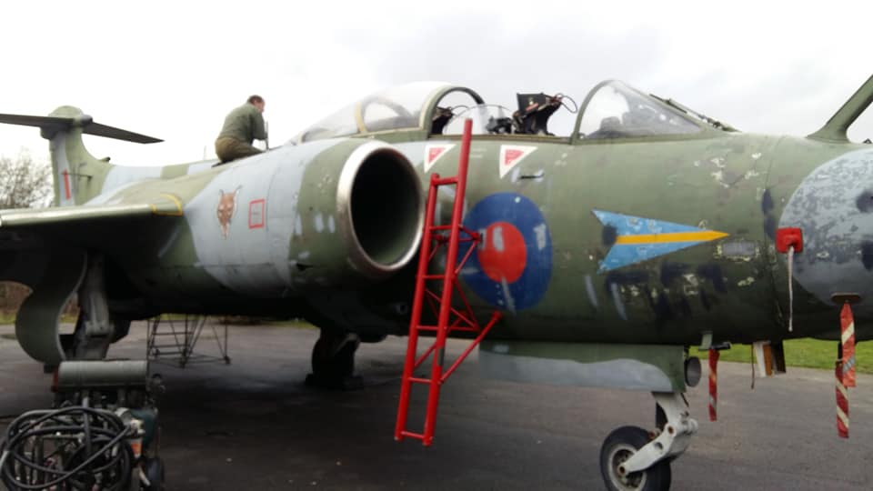

Then, it was out to 168. Scott wanted to getthe bomb bay swung shut, and the airbrakes closed too. Partly to keep the weather out, and partly to keep critters out. Eloise and I dragged the hyd rig round, while Scott got the cover off and opened the canopy
Unfortunately as expected the battery wasn't up to much, so we elected to take lunch and come back for another go with the trolley acc after. On our way to lunch, quite a striking sky presented itself behind a sunlit Lindy...
After lunch, we dragged the acc out. While we were doing so we stopped by the Harrier, freshly removed from the workshop after renovation and repaint and now in the hangar, to admire it...
Then it was back on with the Bucc.
Success! We got the bomb bay rolled shut, and the airbrake closed. I had also taken my compressor out, and topped the tyres up a bit. We then tidied everything back away, declared Cake O'Clock, and then cracked on with the main Meteor job of the day, continuing the effort to remove the old perspex from the canopy...

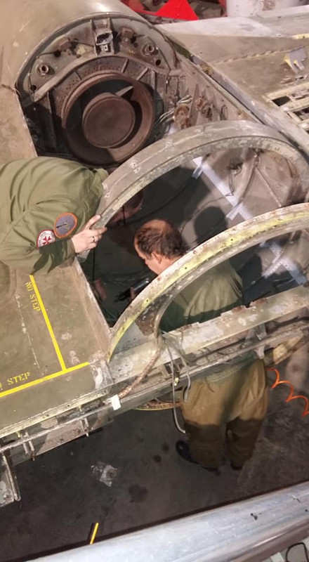

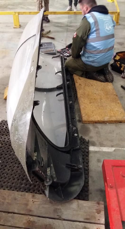

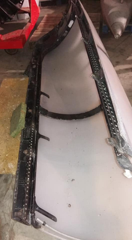

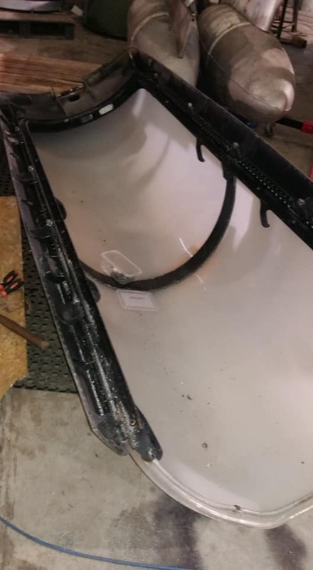

To cut a very long story short, reluctantly just about close of play tonight the perspex finally parted with its home of 55 years, and came out!
This can now go away to friends of ours to be used as a master mould for canopies for our jet and theirs. Exciting stuff!!

Good work on the canopy. Can you tell us what is going to happen to the canopy. Seem to remember there was discussion with other interested Meteor NF14 owners. How many canopy do you expect to make ?
Posts: 103
Hi Blue,
Just wondering, will the master making process destroy the original canopy?
