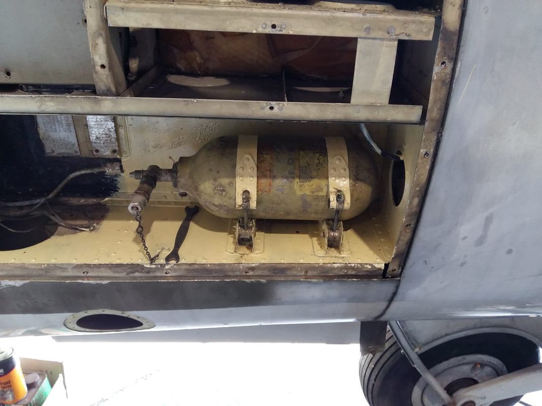

She had lost oil and nitrogen from the port leg. We were able to recharge the Nitrogen, but it didn't lift her back to the right height. So clearly, the oil needed replenishing. More jacking needed, and the jack needed more oil! Meteor team to the rescue with OM15, and a carefully crafted ACME jack refilling device (an old bit of Meteor plumbing and a funnel!)
More jacking, and Andre and I managed to replenish the oil part of the leg
Upshot was, by the end of the day she was better in that the seal was playing ball and she wasn't dumping the new oil out, but she wasn't right as she still wasn't sitting at ride height.

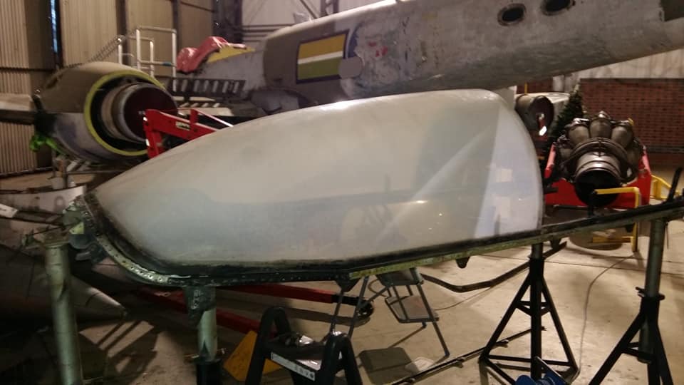

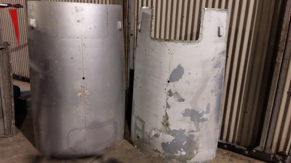

...and as far as engineering goes, the last update of the year! Eloise and myself were in. Our intention was to defeat that canopy...and we were not interested in taking no for an answer! While waiting for Eloise to arrive I made a start winding out the screws from the canopy side shrouds

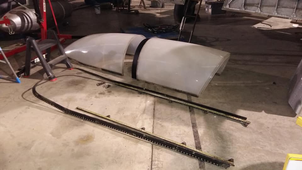

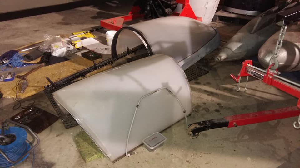

Then, we continued the Battle of the Perspex! This time, it finally saw our point of view.
giving us a bare, grotty canopy chassis

Finally, tonight the viewing window has had the UV damage polished out and is good to go back on!

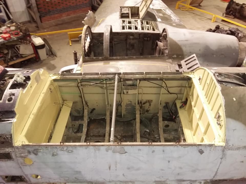

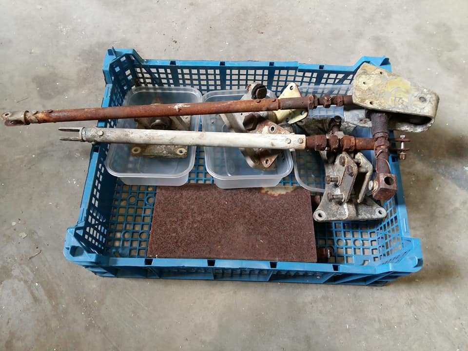

January, we started the year on a high, with the reinstating of the elevator controls.
Image20181229_154337 by Graham Buckle, on Flickr
For the first time since 788 was retired, the elevators are directly controlled from the stick via control rods we were donated, the layshaft retrieved and restored from the Sennybridge wreck, and a replacement set of cables. After this we were on to a much quieter month, restoring items such as gun camera mounts...
Image49499992_2223535511251812_333720599576707072_n by Graham Buckle, on Flickr
Image49899211_2227632360842127_6173307539950665728_n by Graham Buckle, on Flickr
Suppressor box brackets...
Image50073180_2227556000849763_3796731543267835904_n by Graham Buckle, on Flickr
Image50055554_2228188414119855_6378683418527399936_n by Graham Buckle, on Flickr
And lots of chopped cockpit wiring
Image50943442_2236029706669059_1357195728367124480_n by Graham Buckle, on Flickr

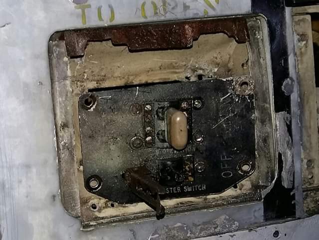

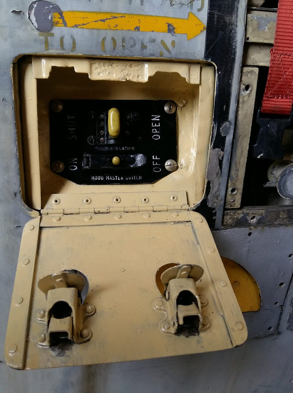

and generally got things ready for putting power on in the cockpit. One little job was acquiring some glass paint (thankyou Hobbycraft!) and setting up a production line converting a box of clear bulbs we had been donated into red instrument panel bulbs. A job sat at home in front of the fire? Don't mind if I do!
Image51475096_2242938622644834_1724391272984084480_n by Graham Buckle, on Flickr
Image51278376_2243017062636990_622207166232657920_o by Graham Buckle, on Flickr
Did painting the bulbs work? Yes it did!

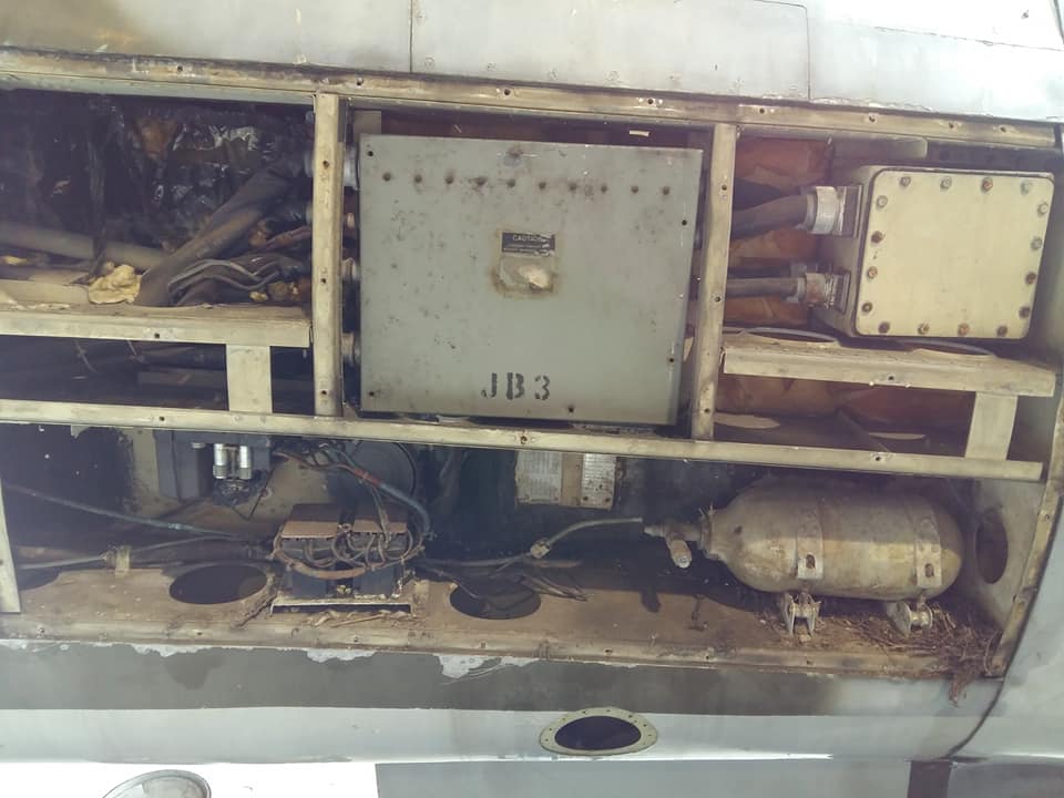

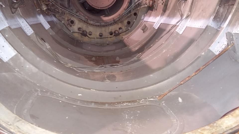

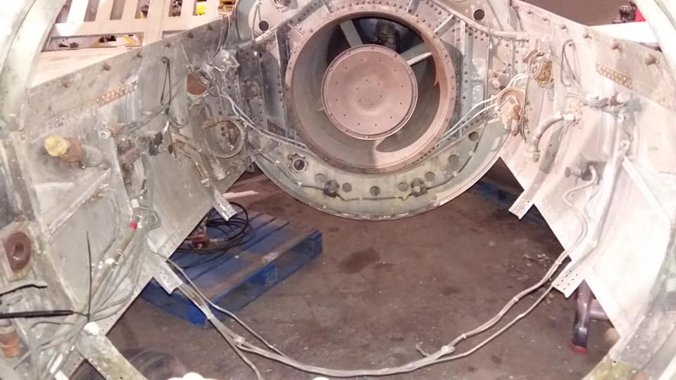

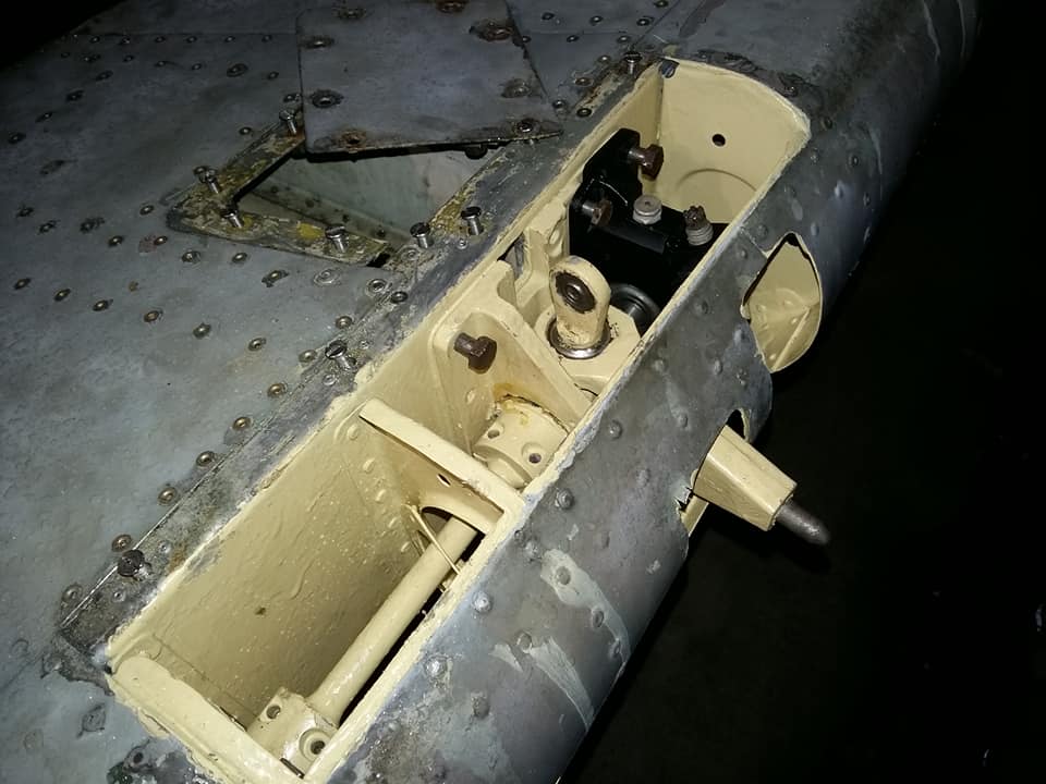

At the end of the month we had our first taste of what has shaped most of the effort this year, metalwork in the control surfaces. Paint stripping the lower rudder leading edge revealed a blister of corrosion...
Image53359688_2255549618050401_1345322359996809216_n by Graham Buckle, on Flickr
This clearly needed further investigation, leading to...
Image53366863_2255549651383731_5257775655252131840_n by Graham Buckle, on Flickr
So, that'll be needing surgery...

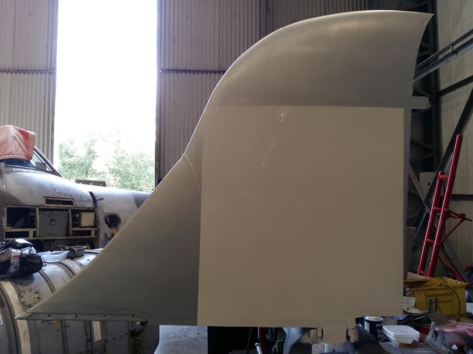

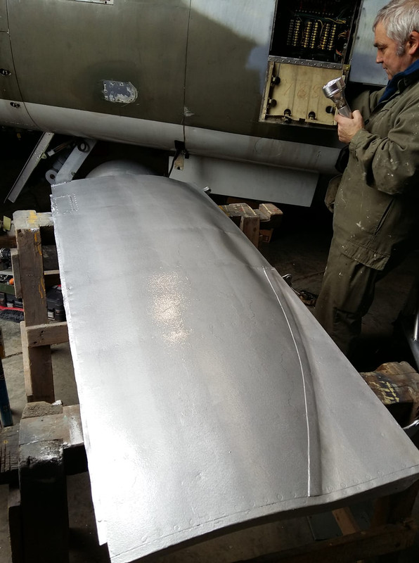

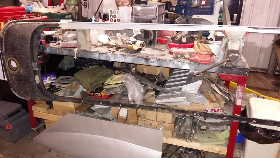

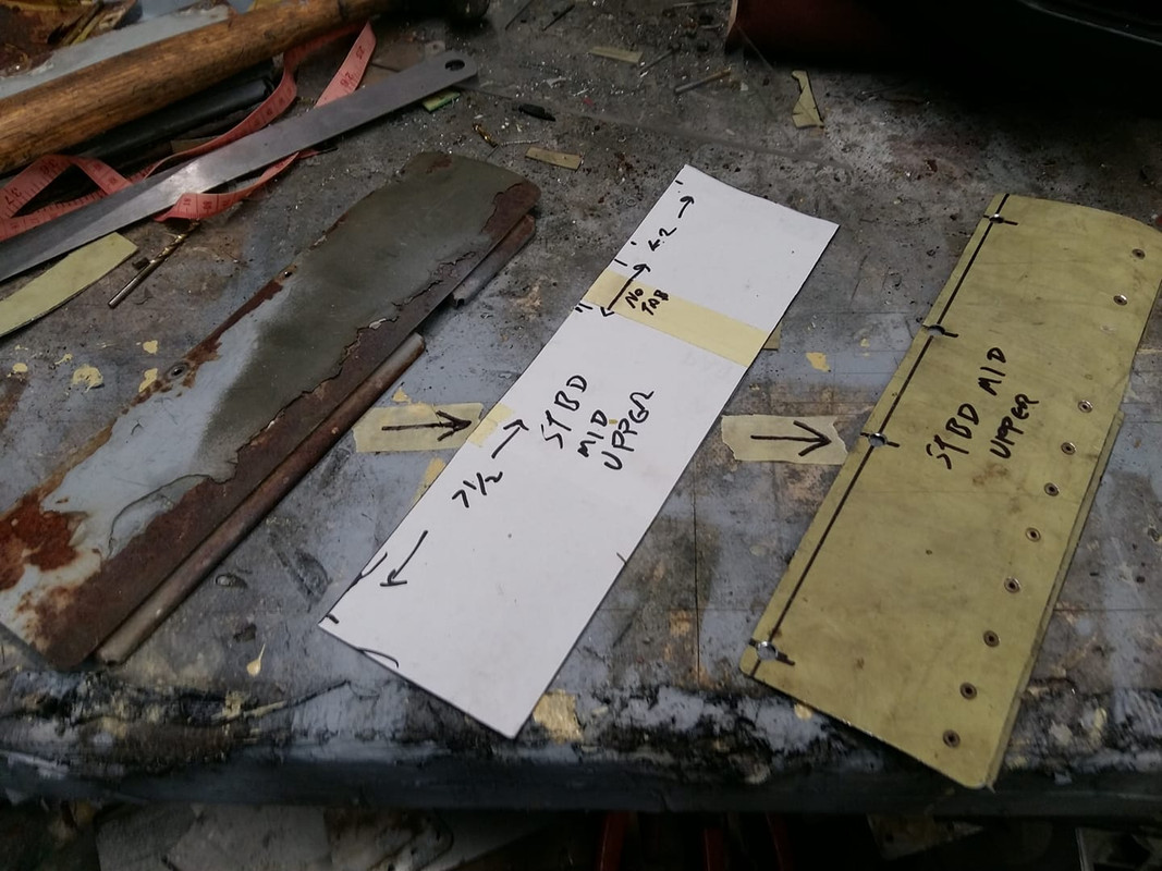

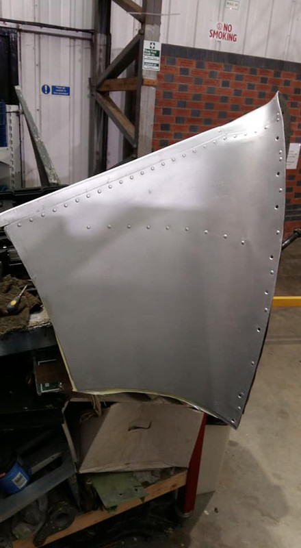

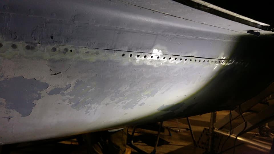

After 788's moment of fame it was back to chasing rot out of the rudder. I ended up making a new leading edge, replacing the original steel item with a thicker gauge alloy. We figure the less steel in the jet, the better.
So rot was chased out of the rudder leading edge, but there was some within the rudder too, so one side skin had to come off to allow this to be treated
Image52920238_2257308617874501_1650647165548101632_n by Graham Buckle, on Flickr
Image53395003_2260945604177469_6565615212886491136_n by Graham Buckle, on Flickr
A few days work saw this done, everything treated and painted, and the rudder ready to reassemble
Image53617016_2261034957501867_6426174254898741248_o by Graham Buckle, on Flickr
Then it was a case of simply make and fit new leading edge section!
Image54729565_2263646487240714_4634160521430433792_n by Graham Buckle, on Flickr

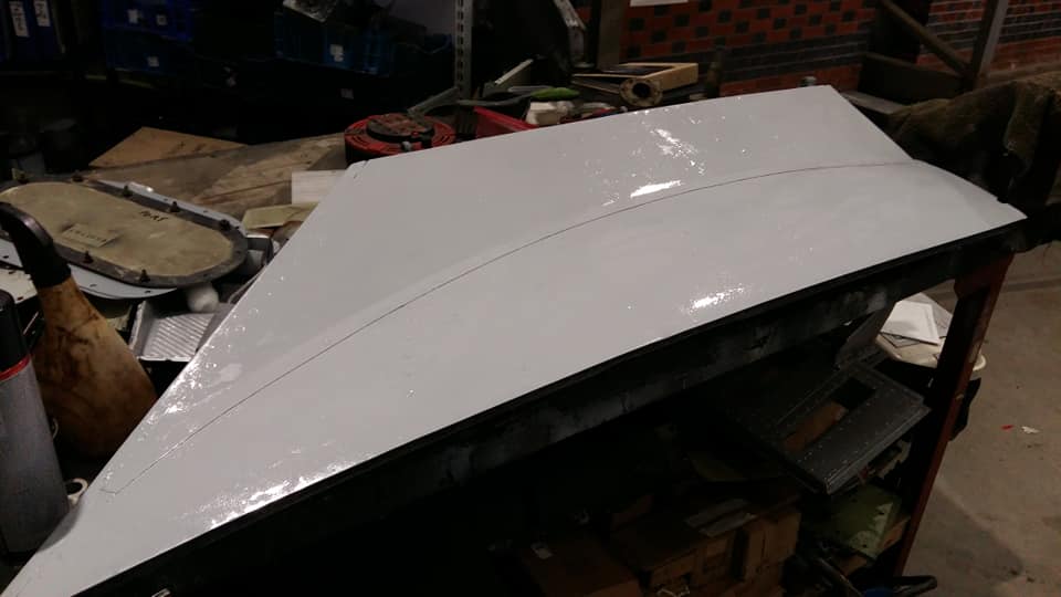

the upper leading edge of the lower rudder was also replaced
Image54523983_2268922440046452_2584250258288541696_n by Graham Buckle, on Flickr
then after stripping and priming, it went into its silver topcoat
Image54524784_2268922676713095_2513968452838883328_n by Graham Buckle, on Flickr

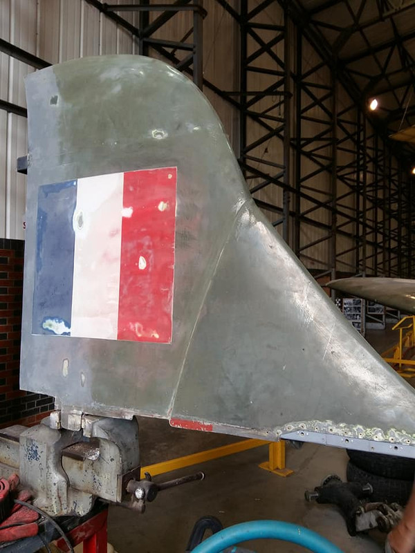

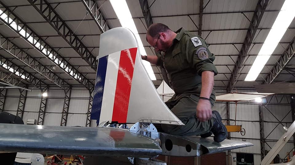

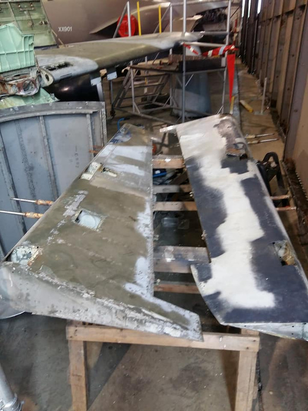

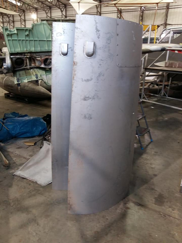

April saw a thorn in our side removed, as the last bolt holding the upper fin on finally stopped being stubborn...
Image55726445_2273460516259311_8579280599204757504_n by Graham Buckle, on Flickr

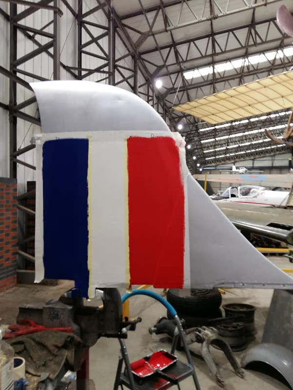

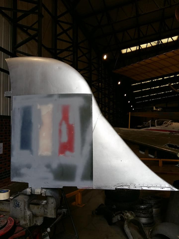

This needed some metalwork repairs. It also wore the remains of the 1ANS tail markings, on the section hidden by the cruciform bullet section. This proved invaluable later in the year as it gave us the measurements for the tail markings! We also finished the lower rudder repaint
Image56897032_2281777938760902_8187118671689154560_n by Graham Buckle, on Flickr

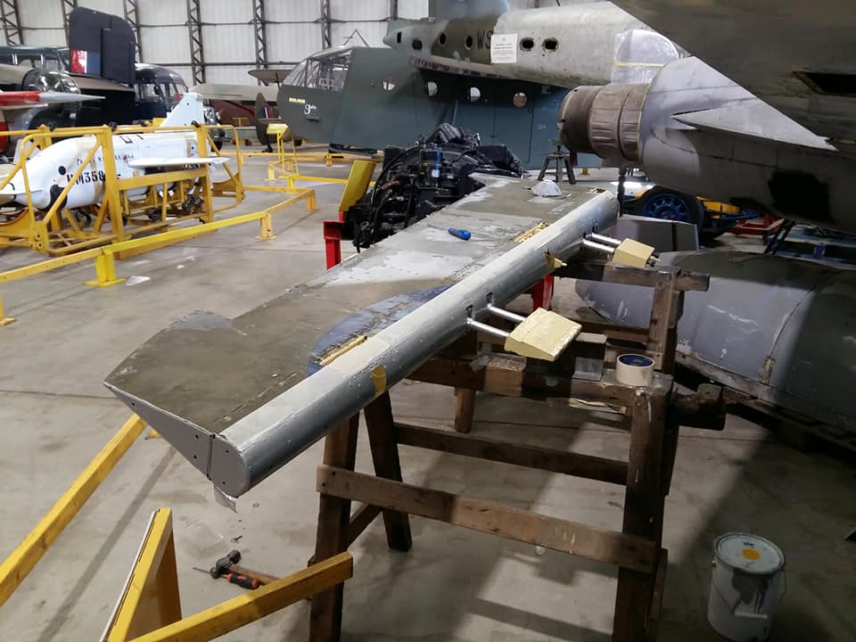

The upper rudder's leading edge was investigated for corrosion too, and found to be perfectly OK. We also made progress on the other end of the jet, with special guest engineer and friend Mike Davey (now more used to getting his hands grubby on Phantoms!) giving us a day, and replacing all the latches on 788's radome
Image58380847_2287355578203138_5228404916535427072_n by Graham Buckle, on Flickr
Before painting it up. It's now ready to fit.
Image57598443_2287456694859693_3971298740962066432_n by Graham Buckle, on Flickr

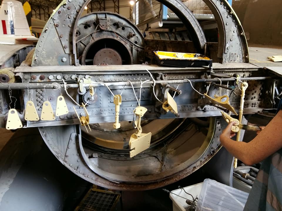

We also began what became the major effort of the year, the removal, restoration and refitting of the ailerons and all associated systems. Starting with accessing the steel hinge covers and the mass balance weights in the wing...
Image61251647_2308767276061968_9093312593111547904_n by Graham Buckle, on Flickr
Image61639245_2308767242728638_8271823514189692928_n by Graham Buckle, on Flickr
From the get go we could tell this was going to be a long task. And it was...
Image60970114_2308767169395312_4174564390437126144_n by Graham Buckle, on Flickr

The starboard main panel revealed a bit of unpleasant nest activity round the emergency air bottle
this was soon treated and the affected area repainted though
The efforts to remove the first aileron, the starboard one, continued too. Rust, rust everywhere!
July started the same way June ended, rust brown! The aileron was dropped and stripped of its rusty fittings
which it turned out our French interns had a knack of turning back to shiny!
The month continued in a similar vein; slowly working our way through stripping the rusty components off the aileron, getting the other aileron ready to drop, cleaning and refurbing components, priming and painting them on our hi-tech paint rig......
Away from the ailerons, the upper rudder also got prepped and painted, and the wiring wizards visited and confirmed they could make us a loom. A huge relief to me, and a great step towards bringing the jet back to life! Hopefully early 2020 it will be with us... But yes, July was all about the ailerons. Later in the month the port one was finally persuaded off
meaning both ailerons were on the trestles. A steady stream of parts from the 2 were flowing to our French interns to be blasted clean, returning, being primed, painted, serviced where necessary, and readied for refitting while the ailerons themselves underwent remedial work for corrosion and damage
Last working day of July saw the rudder finally completed, and looking bloody good!
August... and you guessed it, more aileron giblets, aileron de-corroding, aileron riveting, aileron component fabricating... BLOODY AILERONS!!!
As a change of scenery we rubbed back and repainted the upper fin though
As well as various aileron hinge bays and components

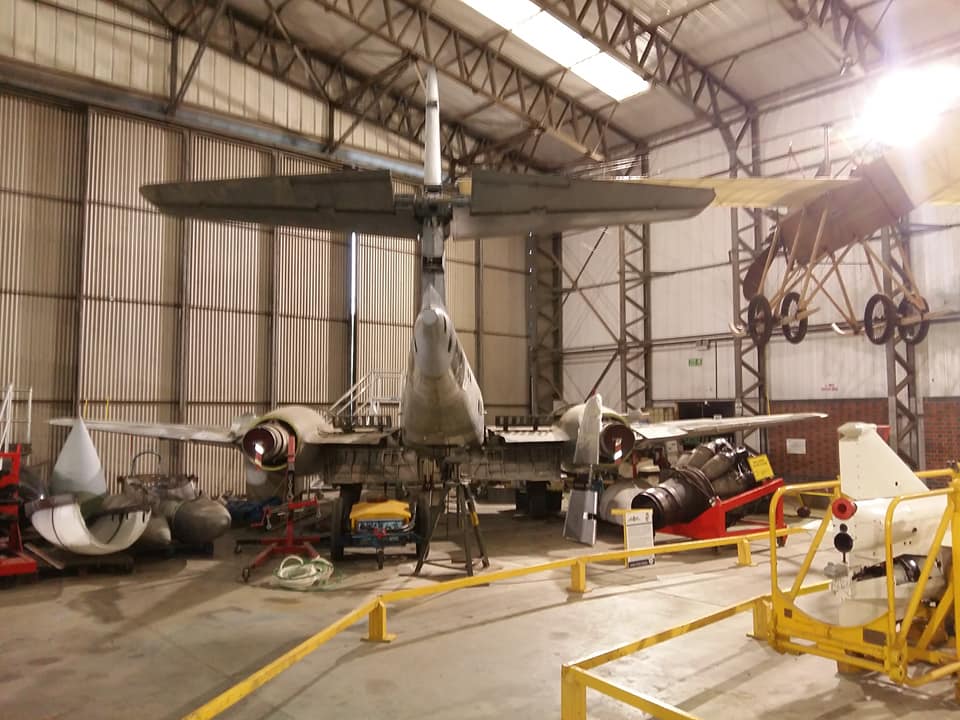

Once the fin was done we decided to put it out of harm's way... back on the jet!
The rest of the month really was more of the same, getting the ailerons worked through. At the end of the month I began the process of replicating the rotten steel hinge access panels though
September began with the ailerons building up nicely, some metalwork making a flush repair for one of the port trim tab skins, and the canopy opening panel coming out for some tlc
This was soon restored and refitted to the jet
The hard work of reassembling the ailerons and making up new hinge covers was nearing completion...

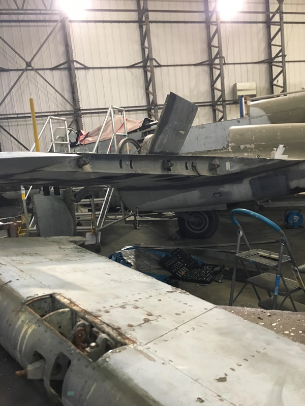

Then in preparation for the refitting, the aileron recesses in the wing and the aileron leading edges were painted silver. A full dry reassembly of the ailerons, mass balances and hinges off the jet was carried out too...
The last working day of the month saw both ailerons back in position, attached to the controls... job done!

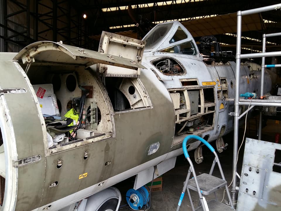

Prior to hurtling headlong into our next big job it seems, stripping out the engine nacelles and replacing their lower halves with NOS items! This started with a hoover out of the ammo, engine and fuel bays. We decided to start on the fuel tank bay repaint while we were at it
then we nipped to the Newark aerojumble, to pick up the skins from our friends from East Midlands Aeropark
before spending a day stripping out the fixtures and fittings from the lower halves of the nacelles. We also continued the canopy dismantle, as well as getting some more bits into paint while the temperatures held
November saw the replacement of all the duff captive nuts from the access panels on both sides of the nose, as we had been provided with new shiny ones! It also saw the beginning of the engine nacelle change...
A long job and a LOT of drilling.
But as you can see from this comparison of the 2 skins, very necessary.

The war on the canopy was then stepped up to priority one, as we have an opportunity for new glazing but ours is needed as a master for the moulds.
December...and yes the christmas tree with Meteor topper was again deployed as a matter of urgency!
After a LOT of hard work over a few months by a number of team members, we got the front perspex out of the canopy finally
And after a similar amount of graft, the rest of the frame was disassembled and the rear half followed
And we have started refurbing the metalwork of the canopy

I got the hatch off, and found someone had been there before me...
Cutting pipes to the ground pressure test connector...
In order to get to, and cut, the canopy jettison lever behind the instrument panel
That's not supposed to look like that...
And this rod is supposed to go through the instrument panel, and have a jettison pull attached. Only it's been snapped off...
Bloody vandalism. I can only assume this was done during her time at Leeming to allow access to the cockpit. I really wish they hadn't... This is more what it should look like...
This we can repair... but we are still left missing a canopy jettison handle. Anyone got one...?
Anyway... back at the bench Lewis had freed off the rollers, so we prepped and painted the rails. Once they had left their hi-tech spray booth (!) we returned them to the canopy area
Before continuing the effort to remove the screw stumps from the side sections of the canopy frame
One down...
Painted and added to the done pile...
2 down...
And again internally painted, and returned from whence it came

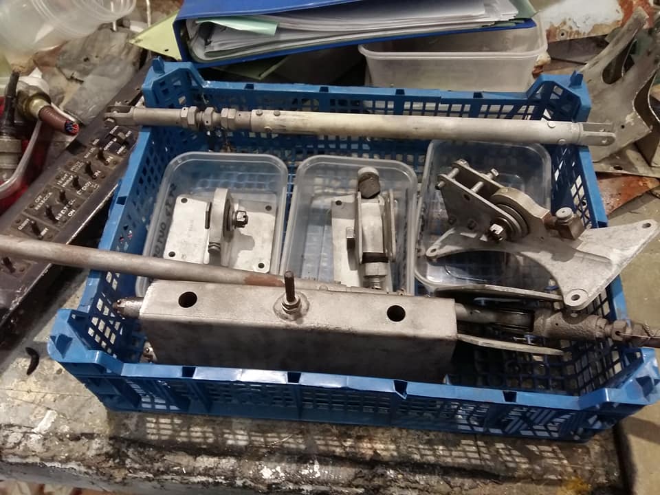

The joys of seized, butchered teleflexes...!! :wall:
