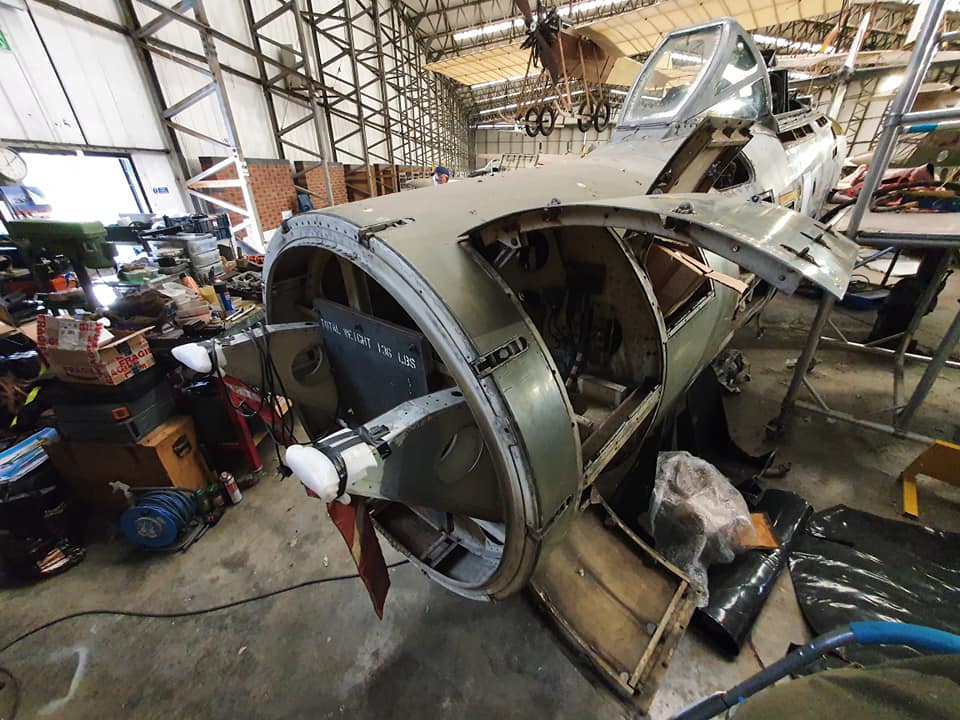

Well another weekend came.... and went.... But we were at the jet today, so have your weekly fix of Meteor doings! My Meteor week started the other day when a parcel arrived from Max Blood. Plumbing for the instrument panel!
Just got to make it look like this now...

It's been a bit of a strange one today, as I seem to have spent most of the day in conversations and impromptu al-fresco meetings about where we are going and what we are doing with 788 rather than actually getting my hands mucky! Still, Simon was in, and he got on with his ongoing battle with the rudder autostabiliser and its bay...
While I got on with repairing our old faithful compressor after several days dragging it around site during the pre-reopening Big Push really took its toll on the poor thing. With that sorted, I took a sneaky peek at Simon's paintwork in the autostab bay
My jobs were at the other end of the jet. While looking for yet another one of those elusive "where the **** did I put that" items, I realised we still had junk in the nose bays of the jet.
So I did the right thing, and dug it all out and chucked it on the shelves.

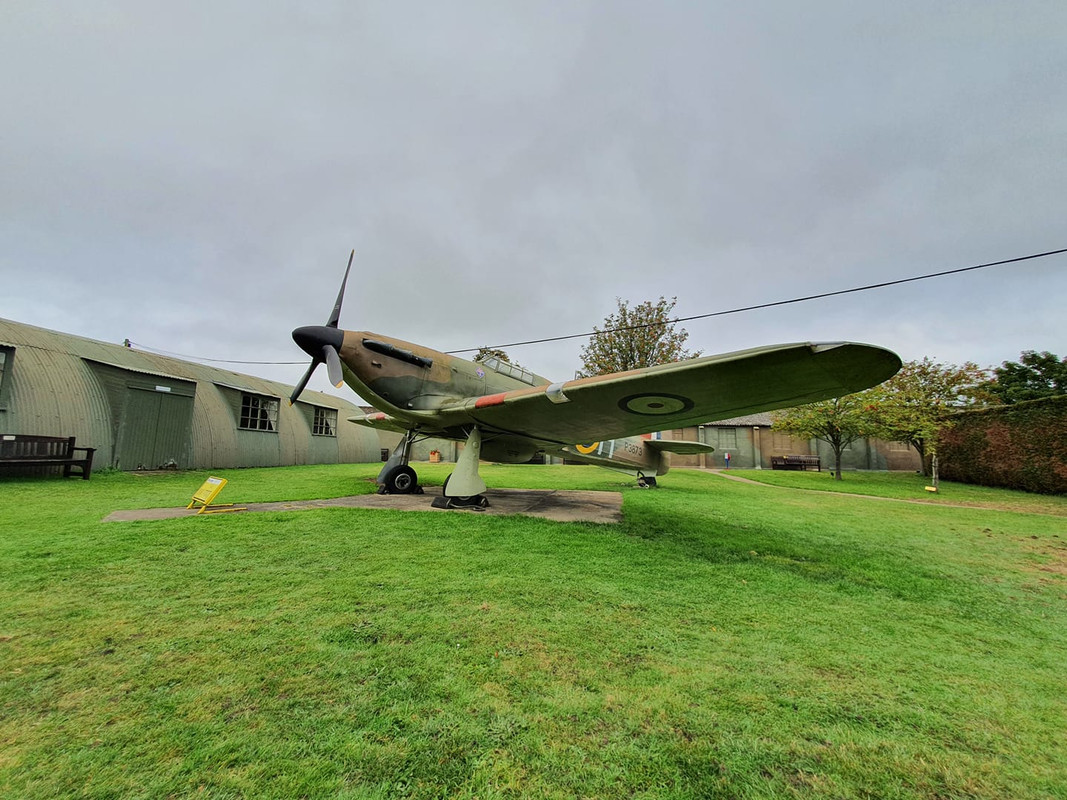

Another day of Meteor fettling; does it ever end! First though I popped by the Hurricane to mark the 80th anniversary of the Battle Of Britain

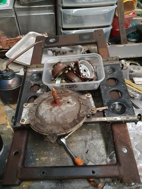

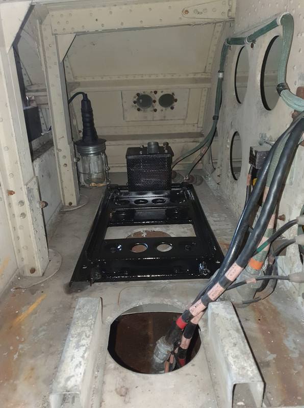

Yesterday's job was to get the rack I had removed from the nose stripped and restored ready to go back in, once the unhappy bit of ally angle has been replaced. It was a nice warm day, therefore a good painting day, so I cracked on dismantling the rack. This used to hold the ARI5860 modulator back when she was a night fighter. This is how it all once looked...
Compared to today, with a 136lb steel plate fitted instead of radar wizardry to maintain centre of gravity.
Let battle commence...

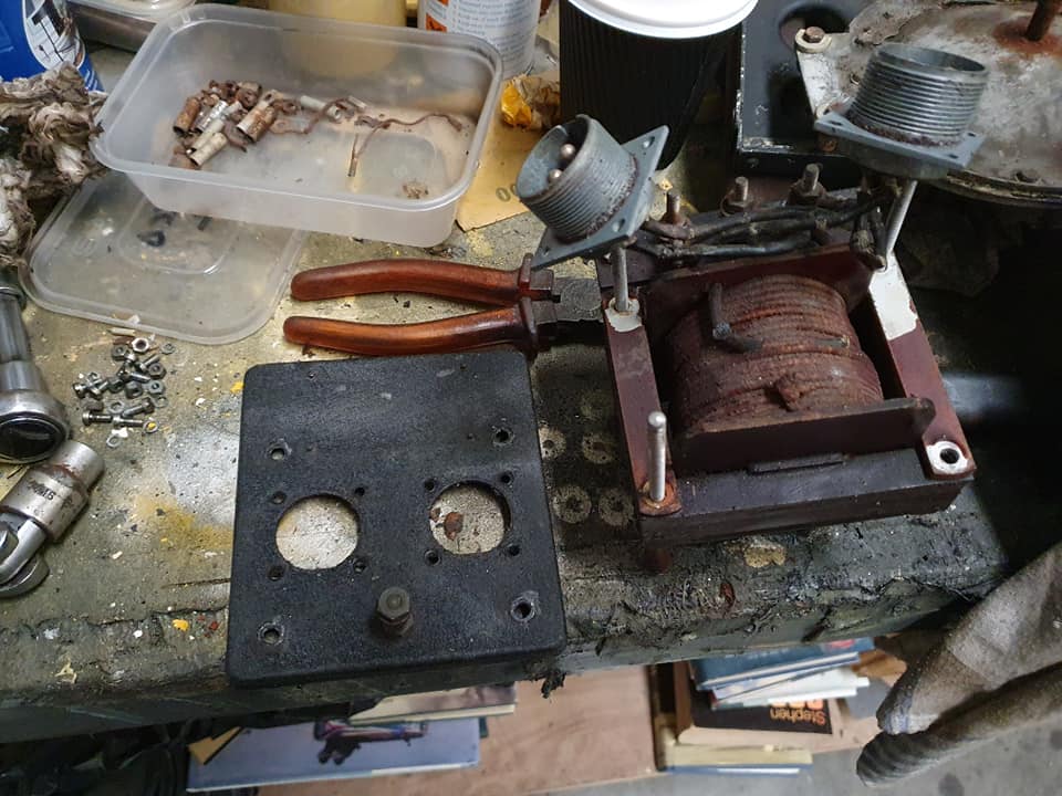

A week left in oil to think about their life choices meant that everyhthing actually complied, and all the major components came apart with little fight

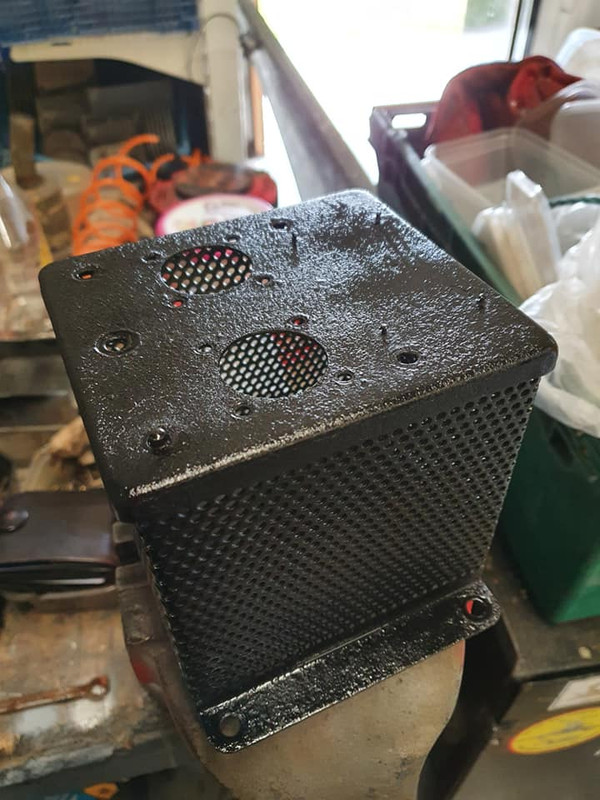

The one remaining black box from the radar set came apart easily enough for repainting and tidying
Considering that is not the most weatherproof of bays, and this component will have not been apart since her NF days ie prior to 1958, I was impressed! The box got painted and set aside to dry while I carried on removing the racking and anti-vibration mounts from the surprisingly crude steel mount base. This process was interrupted, as one of our Facebook followers came bearing the staple fuel of aircraft restorers... Jaffa Cakes!

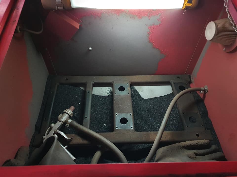

I soon had a heap of parts, to which I added a few canopy mechanism components, to go pay a visit to the sandblaster!
It did a sterling job on the parts, here for example are the mounts
Unfortunately the steel frame was too snug a fit in the cabinet for me to be happy using it...

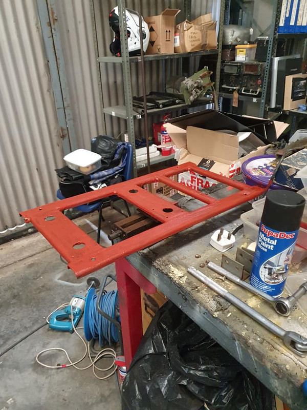

...so plan B was back to the hangar and stick it in the vice, to be attacked with a fibre wheel on a drill! This done, I unearthed my tin of red oxide primer from my MG owning days (any classic British car owner will understand...)

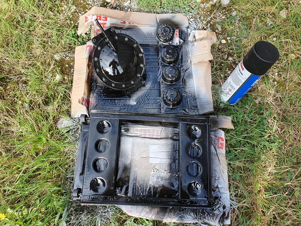

And some more conventional primer for the rest of the bits!
Before breaking out the black. It really was a good drying day
Then, once everything was dry... simply reassemble. Before I forget how it all goes back together...!
Before temporarily chucking it back in its bay for safe keeping. Happy with that for a day's work!

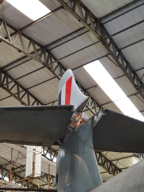

One other occurrence occurred... Our friends on the Buccaneer XV168 team have a mascot, Foxy Dave. There is a long and thoroughly dishonourable history at YAM of team mascots being, shall we say, liberated, and yesterday it was Dave's turn! He has been incarcerated on 788's tail, where he will remain until hostage release negotiations have been concluded satisfactorily...
I just hope he's not scared of heights!
Next weekend we have a pretty full weekend. Saturday would have been Newark Aerojumble, and Simon and I had made the necessary arrangements to go. Then COVID saw that knocked on the head, but rather than waste the day we are heading to East Midlands instead to see our friends there and deliver some goodies for their projects, and collect some for 788. Then Sunday it'll be back to the museum to unload and sort our ill gotten gains, and get a day in on the jet. So next weekend's update will be very busy, very long... and more than likely very late!!
Hope someone remembers to feed Dave this week...

Actual footage of the rescue team inbound Elvington
Posts: 107
I'm guessing that's Blue, masquarading as Lewis Collins?
Posts: 112
No he’s very strict on Covid compliance- he’s wearing the mask 😷
