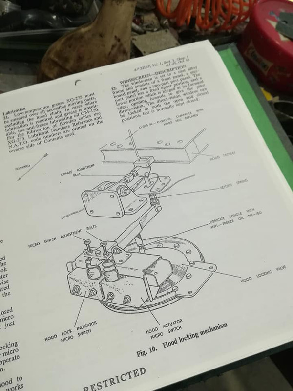

I was on site by myself yesterday, to try and work my way through a few more items on the jobs list of 788. The list appears to be growing faster than we can knock items off it! My start plan for the morning was to get some of the canopy latching gear out of the bay behind the cockpit. The Good Book says 'simply remove'...
And for once, as far as the hood locking valve was concerned, it was not lying!
Access to the bolts was not great though, so this did take a while, a few interesting 'approach angles', and some mild swearing. The microswitches were labelled and dropped pending testing too, and while the canopy hook mechanism chose not to come off, it has been given a good dose of penetrating oil to think about its life choices with during the next week. Other bits of the hook mechanism, and the hook latch shield, did come off and are awaiting some tlc along with the locking valve.

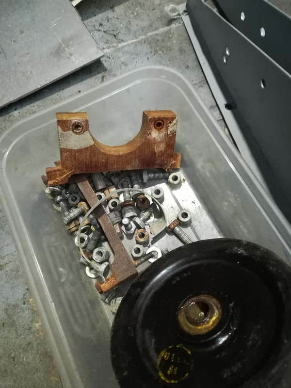

Next port of call was the canopy motor. One look at the motor mounts told me thay would benefit from a squirt of fluid and again some time to consider their options. I removed the pulley cover while I was up there, and found a tale of woe, sadness and misery beneath.
That rusty stalagmite is, believe it or not, the canopy chain. Joy. Still... once all the manky ancilliary bits are out, and we are back to the good base provided by that lovely solid airframe Armstrong Whitworth built, we can always build it all back up using nice new or reconditioned parts. That's the theory anyway.

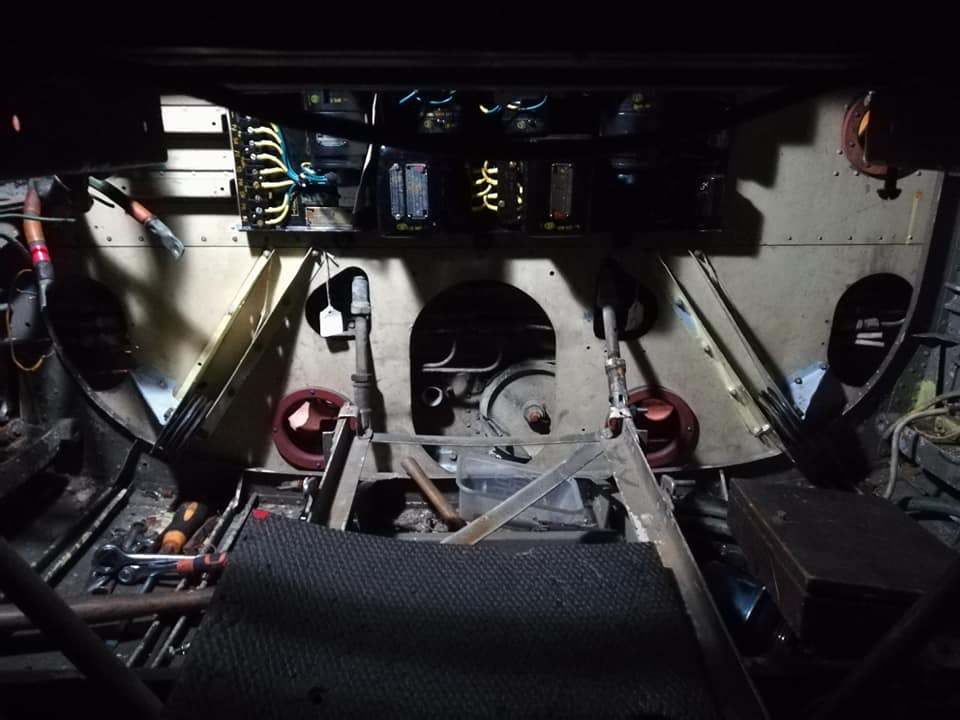

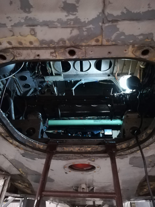

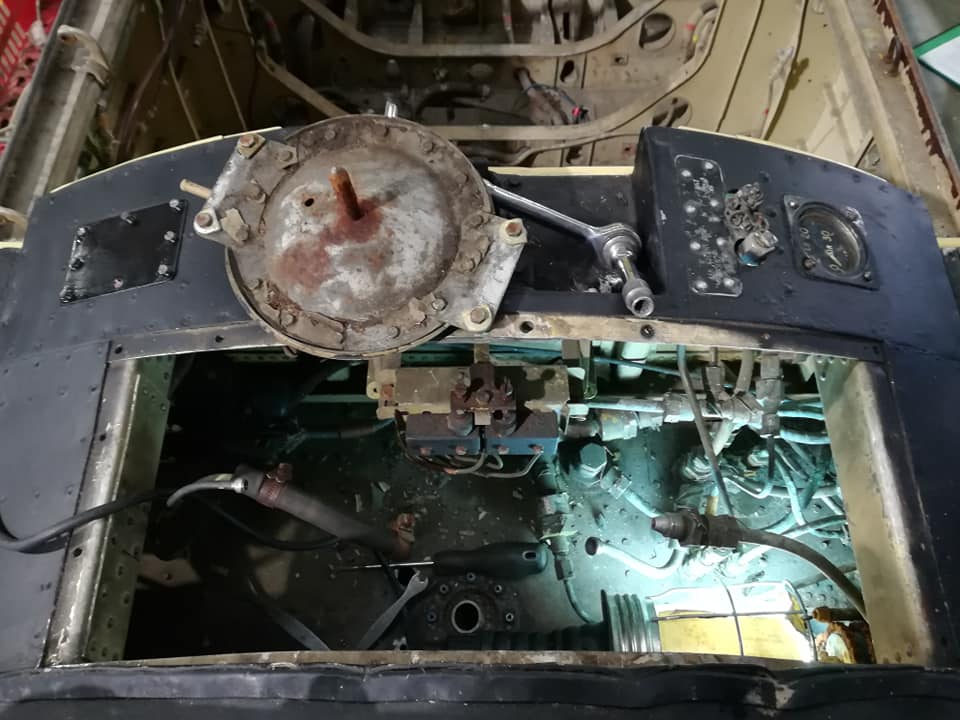

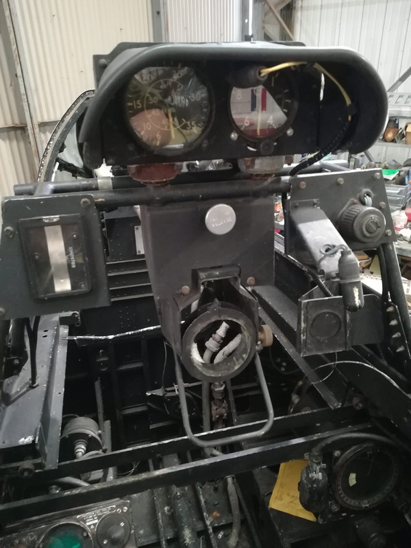

In a shock move, something was fitted to rather than removed from the cockpit yesterday! The corrector card holder arrived in the week, and was fitted to its position on the port panel on the rear cockpit equipment frame
I believe that's most of the NF(T) rear cockpit equipment sourced and fitted now. AP's/documentation detailing the rear cockpit fit is non-existent, so it's been done by referring to photos of all the other incomplete T cockpits out there, period photos, and the recollections of those who flew her. I reckon once the kit is all back in, it'll be something like.

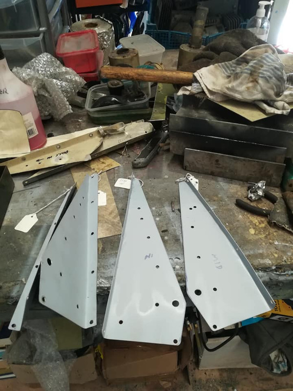

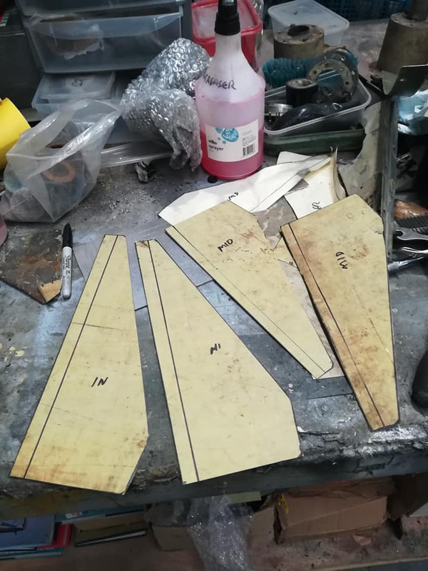

Yesterday I found me a bit of alloy, which was lying around unloved and just begging to be chopped up and condemned to spend the rest of its days in the dark of the Meteor's radio bay, so I obliged. I marked the sheet up from my paper templates, which amazingly hadn't been eaten or blown away during the museum's closure... I then nibbled out the bits I needed to, to make the main cuts more guillotine friendly.
I like to use the guillotine, as it gives a much nicer straight cut than I can ever achieve by hand. It's lovely and quick too. Back from the HP workshop, with 4 pieces of lovely cut metal in one hand, and a brew from the tea van outside the hangar in the other...
next, the business of marking, heating then bending the metal, after which the corners and edges were filed and smoothed, then the new components were primed up in our high-tech spray booth (the gravel, out the fire door and turn right. Can't miss it). Here they are, with the poor mangled wreckage they will be replacing

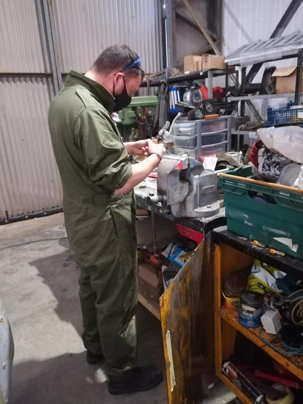

I then struck up another vintage piece of equipment, our pillar drill Terry one of the airfield staff donated to the project.
Cheers Terry, it's a handy bit of kit! It made short work of the job too; soon all the brackets were marked up using the old mangled stuff as templates, and suitably riddled with holes.

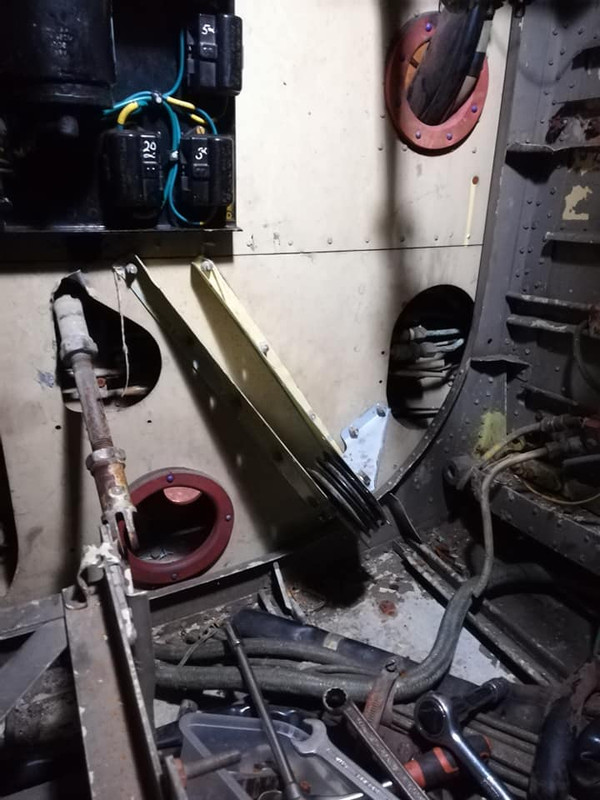

I mocked up the port bracket with its new pulleys, to make sure everything looked correct
Happy with that. Just got to 'liberate' from stores the correct bolts, nuts and shims to mount the pulleys in the brackets now! Then simply remember how this lot goes together
Yeah, that's going to be lots of fun...

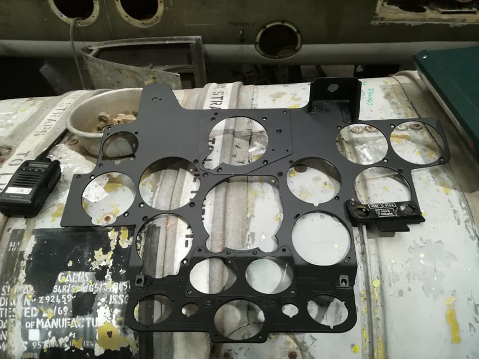

But that wasn't the end of the news on 788 for the day, oh no! Our friends 'somewhere in East Yorkshire' on the Canberra WK124 cockpit project borrowed 788's bare instrument panel to copy as a personal project for themselves, agreeing to return it to me stripped of the old horrible paint. Well, true to their word, I received photos yesterday to show they had indeed done this...
Then I got the message "we're painting the Canberra cockpit interior today, want 788's panel painting while we are at it?"
Well, it seemed rude not to...
...and it does look pretty damn good! Huge thanks to the 124 guys for saving me a job. Looking forward to getting this, the AH adaptor plate and the small caption panel back and building the panel and looms back up! Then, we can fit the panel and have instruments etc hooked up to 788's systems and hopefully functional for the first time since 1966. Exciting stuff...

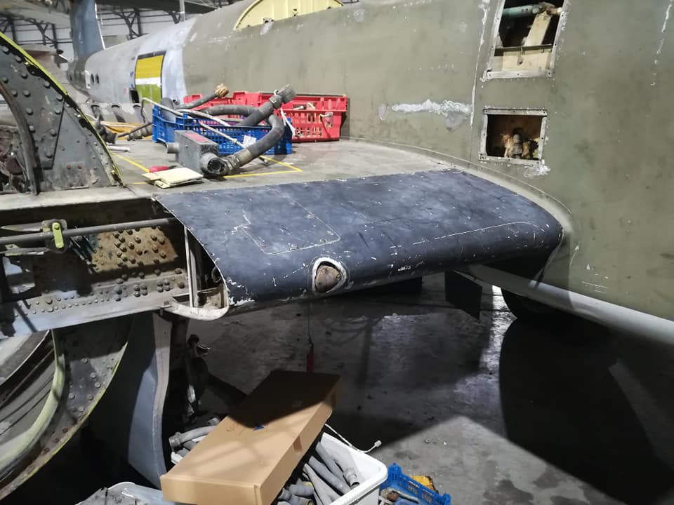

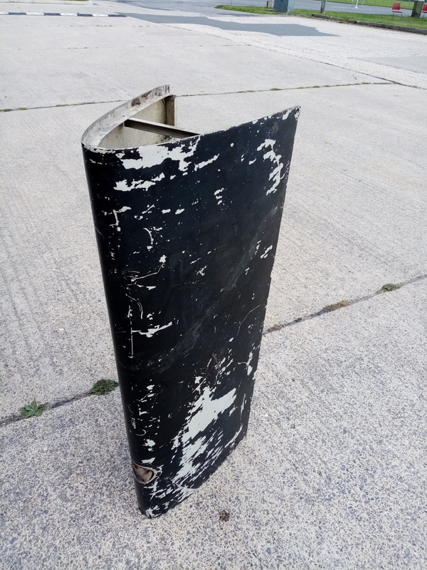

Now, away from food for a second, our Heritage manager Gary returned from Somewhere In The South yesterday, bearing a gift!
Yes, one Meteor NF starboard wing inner leading edge, looking in much better condition than ours! We have been told it is believed to have been 'liberated' from a scrap NF in the 50's/60's, but I haven't any further gen on it at this time to confirm or deny this. This one comes complete with G45 hatch, and the plug in the leading edge for when there is no camera fitted, which ours is missing. So a quick strip, repaint, and fit! Thanks to the person who passed it our way, and to Gary for gathering it up. I'm looking forward to giving this a proper look over, and trying to work out why on earth it's painted black. The only all black NF that springs to mind was poor old WS840, the NF.14 which mostly perished in Northern Ireland during the late 80's. And, of course, this one from the 1983 BBC drama "The Aerodrome" (which incidentally our stored AEC Matador bowser, stored awaiting restoration and still in its paint from this, starred in)...
So yet another mystery for us to mull over, as if we haven't got enough!!

So while Simon made use of the bench to make up new brackets for the rudder autostab housing...
...I got a coat of paint on the rudder pulley brackets I made last weekend

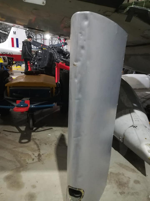

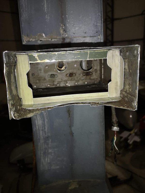

Then took the existing leading edge off and hung the new one on so I could work on it.
It is in much better condition than 788's existing one, which has a very dented leading edge

At close of play I had begun fitting the pulley brackets, and I'm very pleased to say they are a perfect fit!
And Simon's brackets were made, drilled, and test fitted.
They too are spot on. And now, I'm off to bed, as it's all too few hours till I have to be up for work!

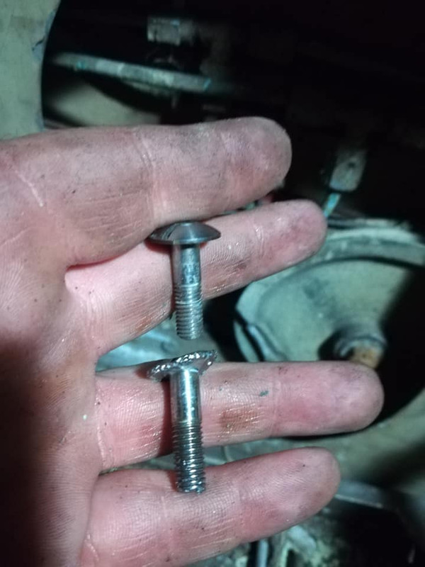

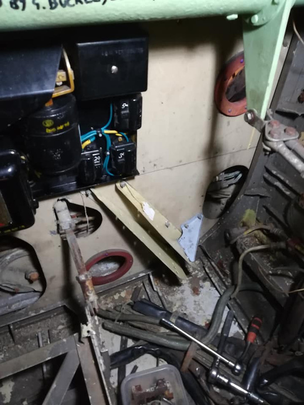

Continuing the fitting of the new rudder pulley brackets, a horrrible job involving getting your hands into places no hand should go. I assume in service this was a 'split fuselage' job. Anyway, first I dropped the fuselage diagonal stays to aid access
Needless to say we won't be reusing the bodge hardware previously "securing" them!
After a lot of time, contortion and swearing, one set was in
Followed by the comparitively easy shimming and fitting of pulleys

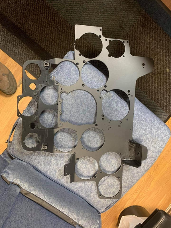

While they were with us, they had brought their brand new replica 14 panel made using 788's as a template...
...so we had to throw it in to see how it looks! Pretty damn good!

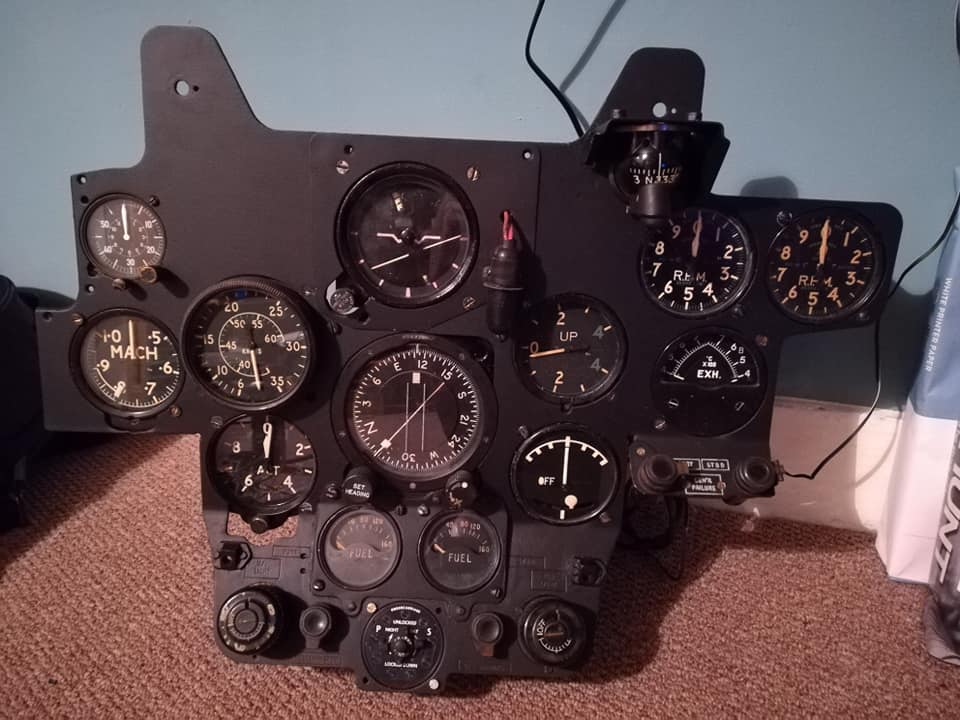

This evening's work. Simply take pile of bits and shiny freshly painted Meteor instrument panel...
...and reassemble!
The AH and fuel gauges will be swapped out as we have new items coming from Bruce of GB Airspares (thankyou Bruce!), but the panel really does look fantastic! Still to be done another night this week, wiring the panel looms back up and writing in the panel captions...

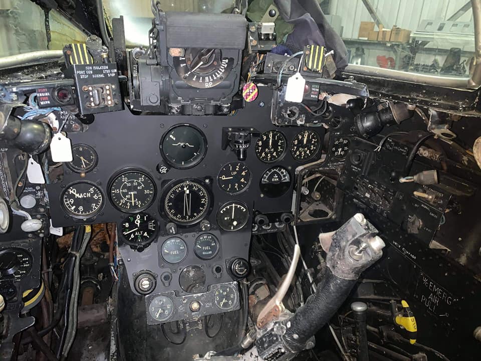

It's great to see all the above progress at last after all the lockdown stagnation, that instrument panel looks good as new.
While we're on the subject, I can't help thinking the instrument layout looks a bit haphazard. It seems to be a bit of a retrograde step from the "basic six" arrangement, what was the designers' logic?
Posts: 394
Cheers Ant! I have tried to keep things moving on the project while we were in the doldrums, but there's really only so much you can do.
In terms of The Grand Plan, this year is a total write off; we are just trying to salvage what we can in the way of man hours on the jet and jobs done from the wreckage of 2020!
The slightly scattered approach of the NF IP is an odd one. I just went through my Meteor Pilot's Notes for most marks starting with an April 1945 issued provisional Mk.III set (the earliest I own), and as far as the single seaters go the panel does alter but keeps what is recognisably the 'basic six' configuration. Mks 3 and 4 have the six in front of the pilot, with the engine instruments below them. Then in the 7 comes the first big change, moving to the same general layout shared by all the later marks with the addition of a machmeter and moving all the engine instruments to the right hand side of the panel. The 'basic six' is still very much front and centre though. It all starts to get a bit wonky after that; in the F.8 I presume due to new instrumentation coming into use, and the attendant fit issues, and in addition cramming the GGS and its attendant tray in above the panel, the AH and compass drop a bit. It's a similar story in the NF.11. By the time you get to the 14, it's all gone the other way for whatever reason. The only reasonable explanation I can think of is to be more easily glanced down at, everything that could be moved down was. Presumably the compass and AH couldn't be moved down because of equipment and the nosewheel bay on the centreline.
I guess we'll never know...
